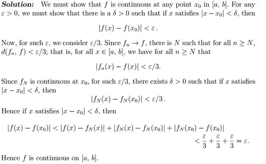

Specifically I was working on the following problem:
Consider the metric space $C[a,b]$ with distance being defined as the supremum norm over the interval. Let $(f_n)$ be a sequence in our metric space that converges uniformly to a function $f$ on $[a,b]$. Prove that $f$ is continuous on $[a,b]$.
The solution, which motivated my question here, is below.

  • The problem I was given gave uniform convergence, and from there we were required to prove continuity. So it was required to consider an expression like $\epsilon /3$ to begin with. – Trogdor Jun 21 '16 at 14:37

  • I was not the one to downvote, but here is the question as you asked.
    Consider the metric space $\mathcal{C}[a,b]$ with distance being defined as the supremum norm over the interval. Let $(f_n)$ be a sequence in our metric space that converges uniformly to a function $f$ on $[a,b]$. Prove that $f$ is continuous on $[a,b]$.
    – Trogdor Jun 21 '16 at 14:43

I think there's a bit of confusion as most of the answers/comments are illustrating the fact that for a typical $\varepsilon$-$\delta$-argument, you let $\varepsilon > 0$ arbitrary and then show that you can always find a suitable delta that keeps some expression below this $\varepsilon$. That is correct but it's not exactly what is happening in your proof. That is, it is more complicated in the sense that there are 'different epsilons' involved.
Your proof is a typical example of where you use certain properties (such as continuity of $f_n$ and the uniform convergence $f_n \to f$) to prove another property (the continuity of the limit function $f$). Now, these earlier, known properties also have $\varepsilon$-$\delta$-definitions and since you assume these properties hold, you know that for any $\varepsilon > 0$, there is a suitable delta that keeps some expression (related to the assumed property) below this $\varepsilon$.
Since these properties hold for any $\varepsilon > 0$, they also hold for $\varepsilon/2$, $\varepsilon/3$ etc. The reason why this comes in handy, is that the definition of the property you're trying to show, also ends in showing that some (other) expression remains below (any) $\varepsilon > 0$. If you use the same $\varepsilon$ for the other, assumed properties and you then use the triangle inequality at the end - like in your proof - you would end up with something like: $$\color{red}{|f(x)-f(x)| <} |f(x)-f_N(x)|+|f_N(x)-f_N(x_0)|+|f_N(x_0)-f(x_0)| < \varepsilon+\varepsilon+\varepsilon=\color{red}{3\varepsilon}$$ Now if you started the proof with "choose an arbitrary $\varepsilon > 0$", you now end up with the 'ugly' $3\varepsilon$ where you want only $\varepsilon$.
You could fix this by choosing an arbitrary $\color{blue}{\varepsilon'} > 0$ at the start and now defining $\color{blue}{\varepsilon'} = 3\varepsilon$ and the final expression also nicely fits the formal definition. Some consider this less elegant and start with $\varepsilon$ but then choose the epsilons you apply to the other, assumed properties as $\varepsilon/3$. You only know the "/3" will do the trick because you use the triangle inequality to split it up in three pieces.

But realistically, for those more experienced here, do you always know to pick the right epsilon to begin with?
No, except for simple things.
Or do you muck around first, then modify the values so then it works out perfectly as in my above example?
Yes, except I often skip the last part. It's just as good when the proof ends with, say, $< 3 \epsilon$ and feels less artificial.
