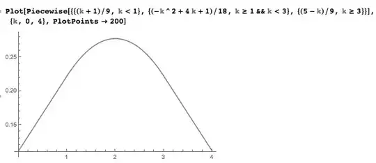

Take left-hand end to have coordinate 0 and right-hand end to have coordinate 6. Let $b$ be the coordinate of the left-hand end of $B$. So $b$ is uniformly distributed on $[0,3]$.
Let the point $X$ have coordinate $x$, so $x$ is uniformly distributed on $[0,6]$.
$X\in B$ iff $x\in[b,b+3]$, and $X\in A$ iff $x\in[k,k+2]$. So for $b\in[-3,k-3]$ we have $A\cap B=\emptyset$. For $b\in[k-3,k-1]$ we have $A\cap B=[k,b+3]$. For $b\in[k-1,k]$ we have $A\cap B=A$. For $b\in[k,k+2]$ we have $A\cap B=[b,k+2]$ and for $b\in[k+2,6]$ we have $A\cap B=\emptyset$.
Case 1: $k<1$. $18p(x\in A\cap B)=\int_0^k2\ db+\int_k^{k+2}(k+2-b)\ db=2(k+1)$.
Case 2: $1\le k<3$. $18p(x\in A\cap B)=\int_0^{k-1}(b+3-k)db+\int_{k-1}^k2\ db+\int_k^3(k+2-b)db=-k^2+4k+1$
Case 3: $3<k\le4$. $18p(x\in A\cap B)=\int_{k-3}^{k-1}(b+3-k)db+\int_{k-1}^32\ db=2+8-2k=10-2k$

Piecewise functions are fiddly and it is easy to make mistakes. So one needs to do some basic checking. (1) Is the result continuous? (Answer: yes), (2) Does the graph look plausible (no obvious odd wiggles etc) (Answer: yes), (3) Does it respect any obvious symmetries in the problem? (The obvious symmetry here is that the probability should be the same for $k=2\pm h$, which it is.)

  • Thanks again . But , sorry ! May be I have not mentioned clear enough . For the statement " B can move freely and uniformly inside E ." I have assumed that the whole segment of B must stay inside E (fully) , no part of B can exceed ( outside ) both ends of E . I apologize for my carelessness ! – mrwong Jun 15 '16 at 10:30
  • Does your graph show that when k = 0 then P will be about 1/9 = 0.11 and when k = 2 then P will be at its maximum value of about 0.28 ? What will be the average value of P ? What will be the values of k for a P of 0.25 ? – mrwong Jun 19 '16 at 04:40
  • @mrwong Look at the formulae above the graph. Yes, the prob is $\frac{1}{9}$ for $k=0$. Yes, the maximum is at $k=2$ with value $\frac{5}{18}\approx0.27778$. To get the average value of the prob you have to integrate assuming $k$ is equally likely to have any value in $[0,4]$. That gives $\frac{23}{108}\approx 0.2130$. The prob is 0.25 for $k$ satisfying $2k^2-8k+7=0$ which gives $k=2\pm\frac{1}{\sqrt2}\approx$1.2929 or 2.7071. – almagest Jun 19 '16 at 10:00
