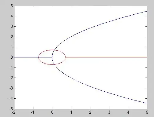

I'm having trouble with this. What i do is say $\epsilon: y=mx+b$ is the tangent and it meets the circle at $M_1(x_1,y_1)$, i equate the $y$ of the tangent with the circle: $y=\pm \sqrt{1/2-x^2}$ and then the same with the parabola at $M_2(x_2,y_2)$, but i can't reach a result. I've also tried with this version of the tangent to the circle: $xx_1+yy_1=1/2$. By theory we know that a conic section has a tangent at a given point when the discriminant is zero when we equate the two. I'm very confused. I don't know how to solve this. If someone could help i would be very grateful. Thanks in advance.
Edit
Below i add a figure of the graph i made with Matlab

It is useful to make a sketch to see what is going on. Added: Nice picture, you can see that there are two common tangent lines, that are symmetrical about the $x$-axis.

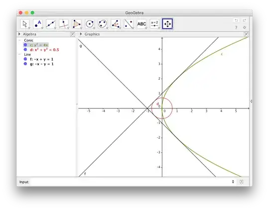

This gives us the four candidates $(h,k) = \left( \pm \dfrac 12, \pm \dfrac 12\right)$, wich corresponds to the four possible tangent lines $y = \pm x \pm 1$. All four of these lines will be tangent to the circle and will intersect the parabola in only one point. But only two of them are going to be tangent to the parabola.
A quick check show that the lines $y = -x -1$ and $y = x + 1$ are the tangent lines.
