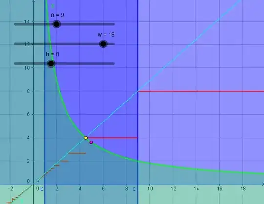

Given are $n \in \mathbb{N}$ and $w, h \in \mathbb{R}$, both positive. We have variables $s \in \mathbb{R}$ and $c, r \in \mathbb{Z}$. The problem is: $$ \begin{array}{lr} \max & s \\ \text{w.r.t.} & c \, s \le w \\ & r \, s \le h \\ & n \le cr \\ & s > 0 \\ & c \ge 1 \\ & c \le n \\ & r \ge 1 \\ & r \le n \end{array} $$ We try to express $r$ in terms of $c$ and $n$, to have just two variables for a graphical solution: $$ \begin{array}{lr} \max & s \\ \text{w.r.t.} & s \le w / c \\ & r(c) = \lfloor n / c \rfloor + \Theta\left( n - c \lfloor n / c \rfloor \right) \\ & s \le h / r(c) \\ & s > 0 \\ & c \ge 1 \\ & c \le n \end{array} $$ where $\Theta$ is the Heaviside function, which can be approximated by $\DeclareMathOperator{sgn}{sgn}\Theta_{1/2}(x) = (\sgn(x) + 1) / 2 $.
A resulting view for $n=9$, $w=18$, $h=10$ is:
graphical solution of some instance
The $x$-coordinate features the choice of $c$, the $y$-coordinate the choice of $s$. The constraint $s \le w/c$ is the light green surface. The upper border of the constraint $s \le h/r(c)$ is formed by the red lines. The feasible region is the area below them, not drawn alas. The constraints $c \ge 1$ and $c \le n$ are the dark blue lines. Finally we have to keep in mind that $c$ is an integer.
The objective is to get a maximal $y$-coordinate within the feasible region.
Here the optimal solution seems be $(c, s) = (5, 18/5)$ (magenta point).
The image suggests to start searching close to the intersection (yellow point) of $s(c) = w/c$ (green line) and $s(c) = (h/n) c$ (light blue line).
