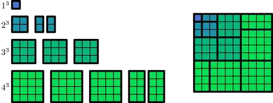

$$1^3+2^3+3^3+...=(\frac{n(n+1)}{2})^2$$
geometric proof: I want a proof using shapes and geometry.

Image source is AoPS
$$\sum_{i=1}^n i^3=\left(\sum_{i=1}^n i\right)^2$$
