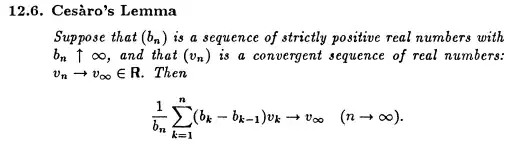

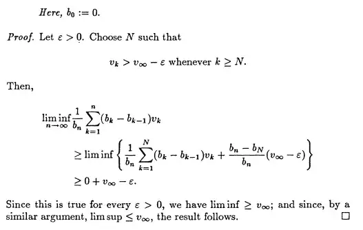

Probability with Martingales:
From Wiki:
What is their relationship? Does any imply the other?

It looks like I can prove Stolz–Cesàro theorem from Cesàro's lemma.
