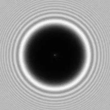

Arago's spot is a classical (and classic) example of a beautiful mathematical theory anticipating a beautiful physical fact. Briefly, the story goes like this: Back in the 1800's, scientists were debating whether light was a particle or a wave. Following some convincing experiments by Young showing wave-like properties of light, Fresnel developed a mathematical wave theory of light to describe the properties exhibited in those experiments. He submitted his theory in a competition, where it was reviewed by Poisson, who was a supporter of the particle theory of light. Poisson wanted to prove it wrong, and so he fiddled with the math until he discovered an effect predicted by the theory (hitherto not noticed by Fresnel) which he thought was inconsistent with experiments: The theory predicted that if you shine light at an opaque disk, there would be a bright spot in the middle of the shadow cast by the disk.
It turned out that no one had actually done an experiment of this type before. So following Poisson's prediction, Arago went and did the experiment, and voila! The spot was there! So Poisson's attempt to kill the wave theory of light ended up becoming one of the strongest pieces of evidence in favor of light's wave nature.
Yly
  • 15,292

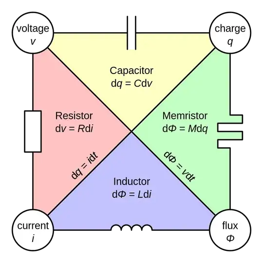

The memristor, the fourth passive electronic component (to accompany the resistor, capacitor, and inductor), was predicted by Leon Chua in 1971. An anomalous signal found by engineers in HP Labs in 2008 was, after much consternation, eventually attributed to the discovery of the memristor.
The prediction follows from the relationship between voltage, charge, current, and flux, neatly represented in the following diagram:
memristor equations
MJD
  • 65,394
  • 39
  • 298
  • 580
Xavier
  • 861
