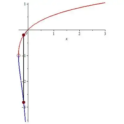

1) Through the real relation between $\W_{-1}(x)$ and $\W_0(x)$
If we graph the two branches in their corresponding domains, which are $[-1/e,0)$ for $\W_{-1}(x)$ and $[-1/e,+\infty)$ for $\W(x)$, we get using the following
with(plots);
W := LambertW;
f := proc (z) options operator, arrow; z*exp(z) end proc;#inverse of W
xbp:= -exp(-1);
dx:= .2;
L := [[xbp, W(xbp)]];
M := [[xbp+dx, W(xbp+dx)], [xbp+dx, W(-1, xbp+dx)]];
p1 := plot(W(x), x = xbp .. 3, scaling = constrained, color = red);
p2 := plot(W(-1, x), x = xbp .. -.1, scaling = constrained, color = blue);
p3 := plot(L, style = point, symbol = circle, symbolsize = 20);
p4 := plot(M, style = line, color = black);
p5 := plot(M, style = point, symbol = solidcircle, symbolsize = 20);
display(p1, p2, p3, p4, p5);
Continuation of branch $\W(x)$ downto $\W_{-1}(x)$ for real $x$, with branch point at $x_{bp}=-1/e$.
The relation between the two real branches is shown with the vertical black line. Unfortunately the relation is the result of multivaluedness, so to pick it up we have to invert the function. After the following code:

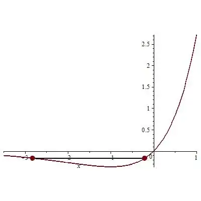

M := [[W(xbp+dx), xbp+dx], [W(-1, xbp+dx), xbp+dx]];
pi1 := plot(f(x), x = -3.5 .. 1, scaling = constrained);
pi2 := plot(M, style = line, color = black);
pi3 := plot(M, style = point, symbol = solidcircle, symbolsize = 20);
display(pi1, pi2, pi3);
Relation between branches $\W(x)$ and $\W_{-1}(x)$ for real $x$, displayed on the inverse of $\W$, $x\cdot e^x$.

And from the graph it is now obvious that,
if $x_{bp}=-1/e$ and $f(x)=x\cdot e^x$, then:
if $x_0=\W(x_{bp}+dx)$ and $x_1=\W_{-1}(x_{bp}+dx)$, then:
$$f(x_0)=f(x_1)$$
The above however resolves trivially, since by the very definition of $\W$, $\W_k(z)\cdot e^{W_k(z)}=z$, $\forall k\in\mathbb{Z}$, so:
$$\begin{align} f(x_0)&=f(x_1)\Leftrightarrow\\ f(\W(x_{bp}+dx))&=f(\W_{-1}(x_{bp}+dx))\Leftrightarrow\\ \W(x_{bp}+dx)\cdot e^{\W(x_{bp}+dx)}&=\W_{-1}(x_{bp}+dx)\cdot e^{\W_{-1}(x_{bp}+dx)}\Leftrightarrow(*2)\\ x_{bp}+dx&=x_{bp}+dx\Leftrightarrow\\ 0&=0 \end{align}$$
In this case therefore, because the resolvent is an identity, we cannot extract a functional relation between the two branches.

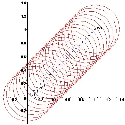

Going from $0$ to $1+i$, through germs.
The strategy now is simple: We have a series at $0$. Use this to calculate $\W(z_1)$, where $z_1$ is a point inside the disk, along the line that connects $0$ with $1+i$.
If we now are given a formula for the derivative of $\W(z)$, we can form a series centered at $z_1$ using Taylor's Theorem. Using the last series, we can calculate $\W(z_2)$, where $z_2$ is a point inside the new disk, along the line that connects $z_1$ with $1+i$.
We repeat the above procedure each time (for each step) using the Taylor's series:
$$f_k(z)=\sum\limits_{n=0}^\infty \frac{\W^{(n)}(z_k)}{n!}\cdot (z-z_k)^n$$
until we reach close to $1+i$. When we are close enough, we can use the last series to calculate $\W(1+i)$. On the picture, the disk centers are marked as blue diamonds and $1+i$ is marked with a black cross. Using $dr\sim 0.067$, the center of the 21-st disk is pretty close to $1+i$.

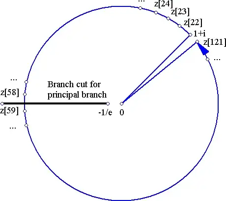

42) Approximation of $\W_1(1+i)$
Now we can use the above code to approximate $\W_1(1+i)$. For this, we construct a path of disk centers $z_{22}-z_{121}$, starting at $1+i$ and rotating counterclockwise(1) until we come full circle back (or close) to $1+i$. Until we reach the branch cut ($z_{58}$), we are still on the principal branch. Subsequent points ($z_{59}-z_{121}$) lie on branch $\W_1$. See figure below:
Complete path from $z_{22}$ to $z_{121}$.

if k < 58 then #we are ready to cross the branch cut! Caution!
print(k+1,z[k+1],Wz,W(z[k+1]),abs(Wz-W(z[k+1])));
else
print(k+1,z[k+1],Wz,W(1,z[k+1]),abs(Wz-W(1,z[k+1])));
fi;
fi;
od;
