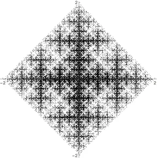

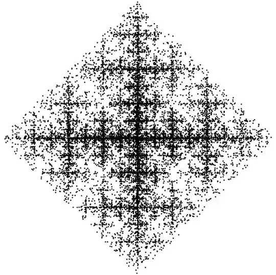

Your image can be generated using a weighted iterated function system or IFS. Specifically, let \begin{align} f_0(x,y) &= (x/2,y/2), \\ f_1(x,y) &= (x/2+1,y/2), \\ f_2(x,y) &= (x/2,y/2+1), \\ f_3(x,y) &= (x/2-1,y/2), \text{ and } \\ f_4(x,y) &= (x/2,y/2-1). \end{align} Let $(x_0,y_0)$ be the origin and define $(x_n,y_n)$ by a random, recursive procedure: $$(x_n,y_n) = f_i(x_{n-1},y_{n-1}),$$ where $i$ is chosen randomly from $(0,1,2,3,4)$ with probabilities $p_0=1/3$ and $p_i=1/6$ for $i=1,2,3,4$.
If we iterate the procedure $100,000$ times, we generate the following image: enter image description here
This image is a solid square but the points are not uniformly distributed throughout that square. Technically, this illustrates a self-similar measure on the square.
To be a bit more clear, an invariant set of an IFS is a compact set $E\subset\mathbb R^2$ such that $$E = \bigcup_{i=0}^4 f_i(E).$$ It's pretty easy to see that the square with vertices at the points $(-2,0)$, $(0,-2)$, $(2,0)$, and $(0,2)$ is an invariant set for this IFS. It can be shown that an IFS of contractions always has a unique invariant set; thus, this square is the only invariant set for this IFS.

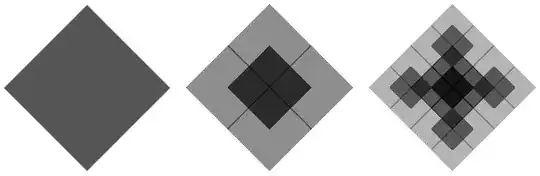

Let's call this square $E$, in honor of its status as an invariant set. We can get a deterministic understanding of the distribution of points on $E$ by thinking in terms of a mass distribution on the square (technically, a measure). Start with a uniform mass distribution throughout the square. Generate a second mass distribution on $E$ by distributing $1/3$ of the mass to $f_0(E)$ and $1/6$ of the mass to each of $f_i(E)$ for $i=1,2,3,4$. We can then iterate this procedure. The step from the original distribution to the next to the next might look like so:
The evolution of the first 8 steps looks like

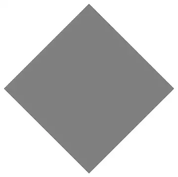

The first, obvious question then is what the fixed set of your iterated function system (i.e. the unique non-empty compact set $S \subset \mathbb R^2$ such that applying each of your affine maps to $S$ and taking the union of the results yields the same set $S$) is. This fixed set is the closure of the limit set obtained by infinitely iterating your function system from any starting point, and thus, in some sense, represents "the" limit shape obtained by iterating your system.
Alas, for your system, the answer is kind of boring: the fixed set is simply a (tilted) square with corners at the top, right, left and bottom of the outer square (i.e. at $(0,\pm1)$ and $(\pm1,0)$ in the parametrization I used above).
The easy way to see that is to observe that the last four maps in your system map this square into four smaller squares that precisely tile the original square (and the first map just produces a square that redundantly overlaps the other four). Another, more rigorous way is to show that any point within this square (and only within this square!) can be approached arbitrarily closely from any starting point by iterating the maps given above in a suitable order.

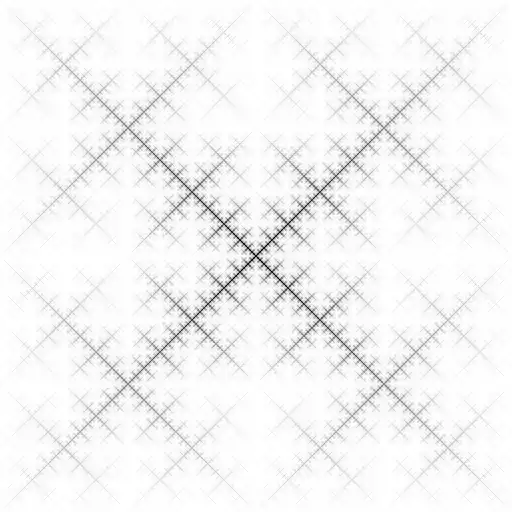

So, if the limit of iterating your system is simply a square, why are you seeing all that interesting fractal-looking structure, then?
The reason for that is the redundant first map (the one that just pulls each point closer to the center of the square), which causes some points in the square to be more likely that others to occur during the iteration. Thus, the invariant measure of your iterated function system will not be the uniform measure over the square (like you'd get if you removed the first map from the system). Rather, it ends up looking like this (rotated 45°, like in my transformed system above):
$\hspace{64px}$Invariant measure
The picture above is a discretized approximation of the invariant measure, with the darkness of each pixel being proportional to the probability of the randomly iterated point landing in that pixel. I obtained this picture simply by starting with the uniform measure on the unit square, and repeatedly adding together scaled and translated copies of it. Specifically, I used the following Python code to do this:
import numpy as np
import scipy.ndimage
import scipy.misc
d = 9          # log2(image size)
s = 2**d / 4   # number of pixels to shift first map by
a = np.ones((2**d, 2**d))
# iteration should converge in about d steps; run for 2*d to make sure
for i in range(2*d):
    b = scipy.ndimage.zoom(a, 0.5, order=1) * (4/6.0)
    a = np.tile(b, (2, 2))  # last four maps just tile the square
    a[s:3*s, s:3*s] += 2*b  # add first map (twice, since it has higher weight)
scipy.misc.imsave('measure.png', -a)  # negate to invert colors
Of course, keep in mind that this is just an approximation of the actual invariant measure, which would seem to be singular.
(If anyone can characterize this measure more explicitly, I'd very much like to see it; the numerical approximation is suggestive, but doesn't really tell much about what really happens in the limit.)
