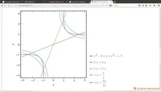

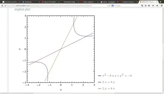

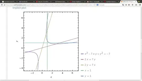

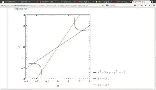

I made a bunch of pictures which show how the argument goes for this problem. All concepts are shown in detail at Is it true that $f(x,y)=\frac{x^2+y^2}{xy-t}$ has only finitely many distinct positive integer values with $x$, $y$ positive integers?
On the other hand, this one is fairly easy and may help people. The Vieta Jumping argument says that, if there are any integer points $(x,y)$ in the hyperbola $$x^2 - q xy + y^2 = -q,$$ with integers $x,y,q > 0,$ then there are integer points that also satisfy $$ 2x \leq qy $$ $$ 2y \leq qx. $$ This viewpoint comes from A. Hurwitz (1907) and clarifies these Vieta Jumping problems nicely.
For now, I am just going to put several diagrams for increasing $q.$ There are no integer points in the central arc for $q=3,4.$ For $q=5$ there are some, namely $(2,1)$ and $(1,2).$ For $q \geq 6$ we see that the central arc has only a very short arc with both $1 \leq x,y \leq 2,$ outside of which there are two fairly long arcs (but still inside the Hurwitz lines) that have either $0 < x < 1$ or $0 < y < 1.$ As a result, there are no integer points satisfying the Hurwitz conditions (which are just the inequalities we get after Vieta Jumping) and therefore no integer points at all.
enter image description here enter image description here enter image description here enter image description here enter image description here enter image description here
