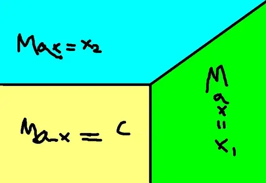

The first key is drawing proper regions for the evaluation of the Max function:
regions
With this we can see that:

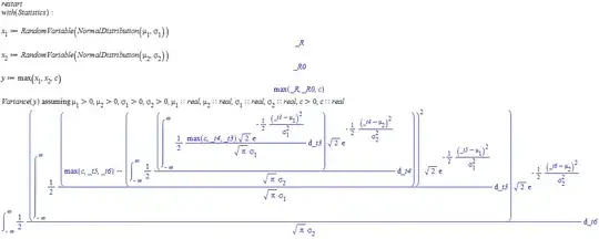

The solution is far from trivial, using Maple I obtained this:
demorge
