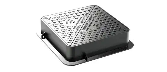

    its actually super easy to find square ones, of course the question still stands from a maths point https://www.google.co.uk/search?q=square+man+hole+cover&oe=utf-8&aq=t&rls=org.mozilla:en-GB:official&client=firefox-a&um=1&ie=UTF-8&hl=en&tbm=isch&source=og&sa=N&tab=wi&ei=XjcWUOHAAuGm0QX4mYGwDA&biw=1920&bih=986&sei=YTcWUP7XHIqU0QXAl4HICA – jk. Jul 30 '12 at 07:28
