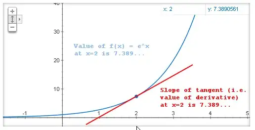

For me (as a non-mathematician), the key property of this number is, geometrically speaking, that the graph of $e^x$ is describing its own slope. I tried to point this out in these images:
Slope_e_01
Slope_e_02
A little bit more formally, this means that $e$ is the only number that has the property
$$ \frac{d}{dx} e^x = e^x$$
which can be seen when plotting both functions.
Certain higher-level mathematical statements (e.g. that $e^x$ is this eigen...vector) are consequences of that.
