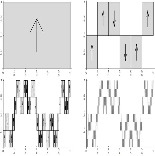

As the Cantor set is self-similar, it makes sense to try to construct a graph with some kind of self-similar structure. The only way the graph of a function can be strictly self-similar is if it is a line segment. Thus, we explore a slight generalization using a self-affine graph. I'll first present an example that is specifically designed to have the desired property and then comment on a couple of cases where such a structure arises quite naturally.
A rigged example
For our first example, we start with the Iterated Function System of six affine functions defined as follows: $$ \begin{align} f_1(x,y) &= \left(\begin{array}{cc} 1/6 & 0 \\ 0 & 1/4 \end{array}\right) \left(\begin{array}{c} x\\y\end{array}\right) \\ f_2(x,y) &= \left(\begin{array}{cc} 1/6 & 0 \\ 0 & 1/4 \end{array}\right) \left(\begin{array}{c} x\\y\end{array}\right) + \left(\begin{array}{c} 1/6\\1/2\end{array}\right) \\ f_3(x,y) &= \left(\begin{array}{cc} 1/6 & 0 \\ 0 & -1/4 \end{array}\right) \left(\begin{array}{c} x\\y\end{array}\right) + \left(\begin{array}{c} 2/6\\1\end{array}\right) \\ f_4(x,y) &= \left(\begin{array}{cc} 1/6 & 0 \\ 0 & -1/4 \end{array}\right) \left(\begin{array}{c} x\\y\end{array}\right) + \left(\begin{array}{c} 3/6\\1/2\end{array}\right)\\ f_5(x,y) &= \left(\begin{array}{cc} 1/6 & 0 \\ 0 & 1/4 \end{array}\right) \left(\begin{array}{c} x\\y\end{array}\right) + \left(\begin{array}{c} 4/6\\0\end{array}\right)\\ f_6(x,y) &= \left(\begin{array}{cc} 1/6 & 0 \\ 0 & 1/4 \end{array}\right) \left(\begin{array}{c} x\\y\end{array}\right) + \left(\begin{array}{c} 5/6\\1/2\end{array}\right) \end{align} $$
The geometric action of this IFS on the upwardly oriented unit square is illustrated in the following figure:
This image shows the oriented initial set, the first two levels of approximation using rectangles, and a higher order approximation to the attractor, which is the graph of a continuous function. Now, it's pretty easy to see that the intersection with the level $n$ approximation by rectangles with a horizontal line segment is just a collection of line segments and that these contain the corresponding intersection at level $n-1$. The intersection of all these is perfect, non-empty, and no where dense. Thus, it's a Cantor set.
This function maps $[0,1]\to[0,1]$ but it's easy to extend to $\mathbb R$, if desired.

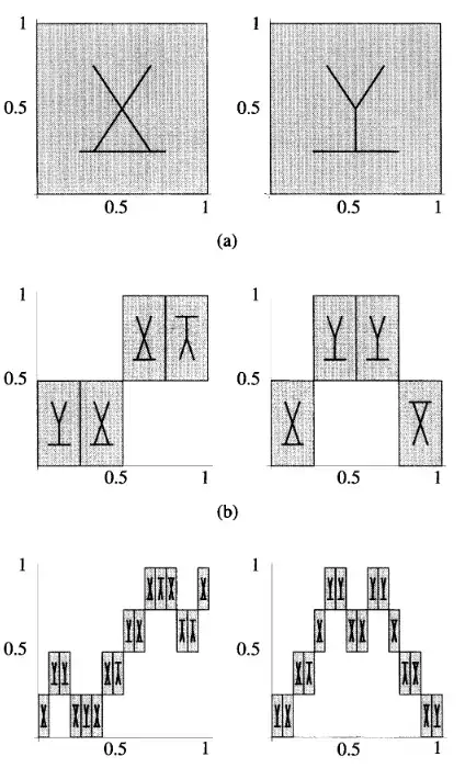

Space-filling curves
The coordinate functions of Hilbert's space filling curve have Cantor type level sets. I proved this in my paper The Hausdorff Dimension of Hilbertʼs Coordinate Functions. I also published a more elementary exposition in The Math Mag. If you understood the previous example, you can see what's going on in figure 7 of that paper:
