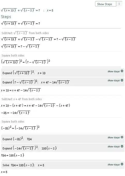

To solve a simple sum of radical equations, you can use with fun and profit the radical equation calculator. It gives you some steps, as describe below:
In your case, a sum of two radicals equating a constant, the "isolate one root and square" method can help: $$\sqrt{x+19}+\sqrt{x−2}=7\,.$$ So: isolate, as much as you can, one radical on one side $$\sqrt{x+19}=7 - \sqrt{x−2}$$ square: $$x+19 = 49 + x-2-14 \sqrt{x−2}$$ simplify and isolate one radical again $$28 =14 \sqrt{x−2}$$ $$2=\sqrt{x−2}$$ then square again, and you get $x=6$. Of course, you need to verify that the solution is valid, for instance that it does not involve radicals of negative numbers.
