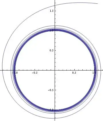

Others have mentioned the topologist's sine curve, that's the canonical example. But I like this one, though it is the same idea:
This is the image of the parametric curve $\gamma(t)=\langle (1+1/t)\cos t,(1+1/t)\sin t\rangle,$ along with the unit circle. There is no path joining a point on the curve with a point on the circle. Yet, the space is the closure of the connected set $\gamma((1,\infty))$, so it is connected.
Plutoro
  • 22,730
  • 41
  • 71
  • If that is the union of $\gamma (t)$ with the circle doesn't that mean that it is disjoint union of two sets. But, circle is not even open. But if it is not disjoint union, then I can always make a path, continue the path from the circle to the curve. *Confused – Chen M Ling Apr 10 '16 at 05:28
  • @ChenMLing It is a disjoint union of the image of $\gamma$ and a circle, but as sets. The topology is vastly different than the disjoint union topology (namely, it's the subspace topology on $\gamma(1, \infty)\cup S^1$ where $S^1$ is the unit circle). – Balarka Sen Apr 10 '16 at 05:34
    This space is the union of two sets, but the circle is not open in the subspace topology. The issue is that the spiral gets arbitrarily close to, but does not touch the circle. If you start on the circle, you cannot leave the circle and go onto the spiral, because there is not place where the spiral meets the circle. – Plutoro Apr 10 '16 at 05:35
    [...] The intuition for why the resulting space is not path-connected is the following: if a path went round and round the spiral and hit a point on the limiting unit circle, then $\lim_{t \to \infty} \gamma(t)$ must exist. That doesn't, so no such continuous path exists. Intuitively, the path has to be "infinitely long", so it cannot be image of $[0, 1]$, which is a nice compact thing. – Balarka Sen Apr 10 '16 at 05:36
  • @Alex&Balarka, so if it is disjoint union of the image of $\gamma$ and a circle, and If Istart on the circle, I cannot leave the circle and go onto the spiral, doesn't that mean basically the circle disconnected from the spiral, but very tiny that we cannot see. – Chen M Ling Apr 10 '16 at 05:51
  • @Chen No, this is the crux of the difference between connectedness and path connectedness. No matter how close you want to get to the circle without touching it, the spiral gets closer. The two cannot be separated. – Plutoro Apr 10 '16 at 05:54
  • @Alex. Hmm... But you said previously that the spiral gets arbitrarily close to, but does not touch the circle. – Chen M Ling Apr 10 '16 at 05:58
  • Yes, I did. The spiral does not touch the circle. It just gets closer, and closer, and closer, without ever touching. – Plutoro Apr 10 '16 at 06:19
  • Yes. I kinda have an intuition by your answer and Brian's above. Many thanks, Alex :) – Chen M Ling Apr 10 '16 at 06:26
    @ChenMLing Suppose you look at $X = (0, 1) \cup {1}$ and give it the subspace topology from $\Bbb R$ where it lives. That's a disjoint union of sets, because $(0, 1)$ does not contain ${1}$. Yet it's connected. This is because due to the topology $1$ is not isolated: it's a limit point. The analogous thing here is that the unit circle is a limit circle of the spiral $\gamma$. – Balarka Sen Apr 10 '16 at 10:18
  • Oh I see. That makes sense. Thanks Balarka :) – Chen M Ling Apr 10 '16 at 10:22

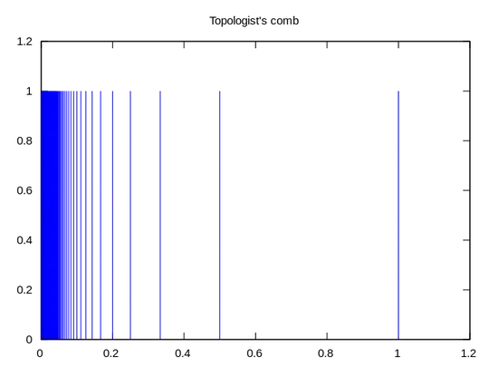

This picture of the comb space from the Wikipedia article on it may help: Comb space
This answer contains a pretty extensive discussion of why the deleted comb space, though connected, is not path-connected. (The deleted comb space has only two points on the $y$-axis, the origin, and $\langle 0,1\rangle$. There is no path from $\langle 0,1\rangle$ to any other point of the space.)
Brian M. Scott
  • 616,228
  • I don't understand this picture. The blue lines seems not connected to each other. No? – Chen M Ling Apr 10 '16 at 05:31
  • @ChenMLing: Did you look at the Wikipedia article? The space includes $[0,1]\times{0}$, the spine of the comb. – Brian M. Scott Apr 10 '16 at 05:33
  • Oh sorry, yeah it's connected. But then I can make a path from any point in the blue line, going down then go to other point in other blue line. Am I wrong? – Chen M Ling Apr 10 '16 at 05:38
  • @ChenMLing: You’re not wrong: if you remove the point $\langle 0,1\rangle$ from the deleted comb space, what remains is path-connected. That’s one thing that makes it nice: there’s just one point that isn’t connected by a path to anything else, so one can see relatively clearly what is keeping it from being path-connected. – Brian M. Scott Apr 10 '16 at 05:40
  • Why I cannot make a path from $<0,1>$ to other point in the space? Is it because the $y$-axis only contain two points, 0 and $<0,1>$? So, it's not connected along the $y$-axis? – Chen M Ling Apr 10 '16 at 05:45
  • @ChenMLing: It’s a bit more complicated than that, as you’ll see if you work through the answer that I linked, but yes, the basic reason is that ${0}\times(0,1)$ is missing from the space. – Brian M. Scott Apr 10 '16 at 05:46
  • So if ${0}\times(0,1)$ is missing from the space, how could you justify that it's still connected on the $y$-axis? – Chen M Ling Apr 10 '16 at 06:02
  • @ChenMLing: It's pretty straightforward to prove that the only clopen set containing $\langle 0, 1\rangle$ is the whole space, so the space is connected. – Brian M. Scott Apr 10 '16 at 06:07
  • I guess the idea is just like above answer with circle and spiral curve. They're connected but one cannot make a path from circle to the curve as if it doesn't touch. Thanks so much, Brian :) – Chen M Ling Apr 10 '16 at 06:15
  • @ChenMLing: That's the right intuition, yes. You're welcome. – Brian M. Scott Apr 10 '16 at 06:20
