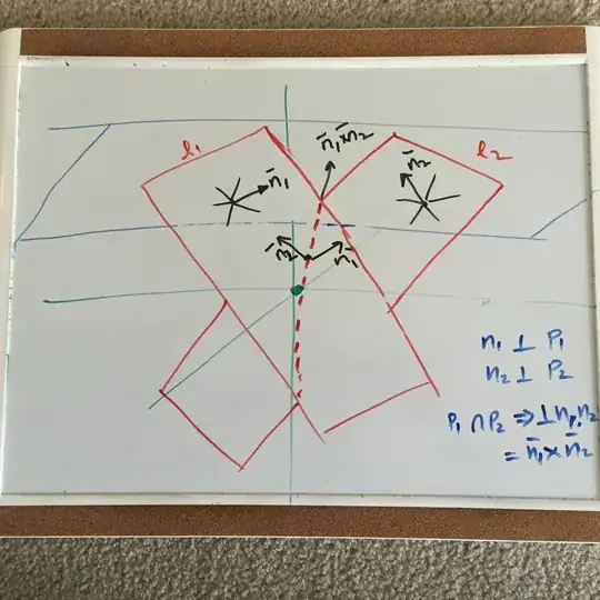

Now the key feature of the cross product is that the result is orthogonal to both the arguments. So you have two vectors $l_1$ and $l_2$, and both of them represent a plane in space through the origin and orthogonal to that vector. So the line of intersection is the set of all vectors orthogonal to both, and any one such vector can be used to describe the direction of the line.

@MvG has answered it and I accepted it. I just wanted to post a picture I've drawn for this to help me understand in case if someone else finds it useful.
Interpretation of line intersection in homogeneous space
