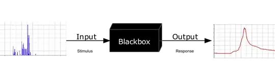

The Black Box Model
Suppose you have a black box in which a signal $x(t)$ is inputted. This signal is processed in the black box and produces an output signal $y(t)$. Then it says that this black box processes the input signal and it produces the output signal, both in the time domain. Note that the black box model can be used to model any type of system. There are no limitations on it. Black Box Model This black box can be modeled mathematically with a function $h(t)$ (also in the time domain) so that you can set the output signal $y(t)$ by convolution process of the system function $h(t)$ and input signal $x(t)$. Algebraically: $$ y(t) = h(t) \ast x(t) $$

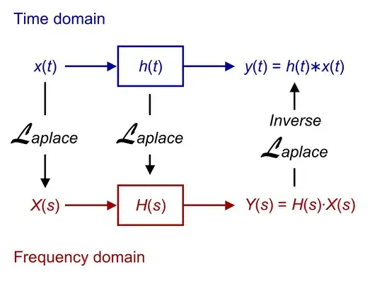

How the Black Box Model is related to the Laplace and Fourier transforms?
The relationship between the Laplace/Fourier transform and convolution is the following property: $$ y(t) = h(t) \ast x(t) \quad\xrightarrow{\mathcal{F}}\quad Y(\omega) = H(\omega) X(\omega) $$ Is interpreted as the transform of a convolution between $h(t)$ and $x(t)$ is multiplication of $H(\omega)$ and $X(\omega)$. So, the convolution in the time domain becomes a multiplication in the frequency domain. This is very useful since compute a multiplication is much simpler than computing a convolution.
Note that there is no restriction on using the Fourier transform or the Laplace transform to do this. However, the definition of the Laplace transform is more generic with respect to the Fourier transform, since $s=\sigma + \omega i$. $$ \begin{align} \mathcal{L}\left\{ f(t) \right\} &\triangleq \int_{-\infty}^{+\infty} e^{-st} f(t)dt = F(s) &&& \mathcal{F}\left\{ f(t) \right\} &\triangleq \int_{-\infty}^{+\infty} e^{-j\omega t} f(t)dt = F(\omega) \end{align} $$ $$ \Longrightarrow\quad \begin{matrix} f(t) & \quad\xrightarrow{\mathcal{L}}\quad & F(s) \\ f(t) & \quad\xrightarrow{\mathcal{F}}\quad & F(\omega) \end{matrix} \quad\therefore\quad \left. F(s) \right|_{\sigma = 0} = F(\omega) $$ For this reason, the Laplace transform is used. In addition, the variable $ s $ provides additional information because:
  • Variable $\omega$ is related to the permanent system response; and
  • Variable $\sigma$ is related to the inherent attenuation of the system.
$$ y(t) = h(t) \ast x(t) \quad\xrightarrow{\mathcal{L}}\quad Y(s) = H(s) X(s) $$ Therefore, the Laplace transform is a powerful tool to analyze a general system, and even allows obtain the function $h(t)$ and/or $y(t)$ using the inverse transform with the following procedure:
