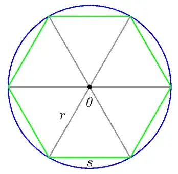

Consider a regular polygon with side length $s$ inscribed in a circle with radius $r$. Let $\theta$ be the measure of a central angle subtended by a side of the regular polygon as shown in the figure below.
regular_hexagon_inscribed_in_a_circle
As you observed, since a full revolution is $2\pi$ radians, each central angle that subtends a side of an inscribed regular polygon with $n$ sides has measure $$\theta = \frac{2\pi}{n}$$ Each triangle that is formed by connecting the center of the circle to adjacent vertices of the inscribed regular polygon is isosceles since the segments connecting the center to the vertices are radii of the circle.

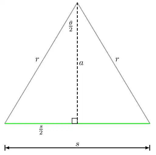

Let's look more carefully at a triangle formed by connecting the center of the circle to adjacent vertices of the regular polygon. If we draw an altitude from the vertex angle to the base of an isosceles triangle, it bisects both the vertex angle and the base, as shown in the Figure below.
side_of_regular_polygon_inscribed_in_a_circle
The perimeter of a regular polygon with $n$ sides of side length $s$ is $P = ns$. Since $$\frac{s}{2} = r\sin\left(\frac{\theta}{2}\right)$$ and $$\frac{\theta}{2} = \frac{1}{2} \cdot \frac{2\pi}{n} = \frac{\pi}{n}$$ we have $$\frac{s}{2} = r\sin\left(\frac{\pi}{n}\right) \implies s = 2r\sin\left(\frac{\pi}{n}\right)$$ Hence, the perimeter of the regular polygon is $$P = ns = n\left[2r\sin\left(\frac{\pi}{n}\right)\right] = 2nr\sin\left(\frac{\pi}{n}\right)$$ Note that the length of the altitude of the triangle is $$a = r\cos\left(\frac{\theta}{2}\right) = r\cos\left(\frac{\pi}{n}\right)$$ Hence, the area enclosed by the triangle is \begin{align*} A_{\triangle} & = \frac{1}{2}sa\\ & = \frac{1}{2}\left[2r\sin\left(\frac{\pi}{n}\right)\right]\left[r\cos\left(\frac{\pi}{n}\right)\right]\\ & = \frac{1}{2}r^2\left[2\sin\left(\frac{\pi}{n}\right)\cos\left(\frac{\pi}{n}\right)\right]\\ & = \frac{1}{2}r^2\sin\left(\frac{2\pi}{n}\right) \end{align*} Since the area enclosed by the regular polygon is comprised of $n$ such triangular regions, the area enclosed by the regular polygon is $$A = \frac{1}{2}nr^2\sin\left(\frac{2\pi}{n}\right)$$ which agrees with the answer you obtained by taking one of the legs as the base of the triangle.
