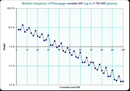

in logarithmic scale imglog
We see the clear logarithmic decrease of frequencies with a small jittering disturbance over the residue classes. It is also obvious, that the smaller primegaps dominate the larger ones, so that a "slot" which catches the primegaps of lengthes $2,12,22,...$ has more occurences than the "slot" which catches $8,18,28,...$ - just by the frequencies in the very first residue class. The original table of frequencies in the residue classes modulo 10 splits this into 16 combinations of pairs of 4 residue classes and the observed non-smoothness is due to that general jitter in the resdiue classes of the primegaps.

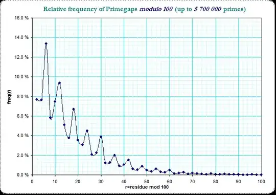

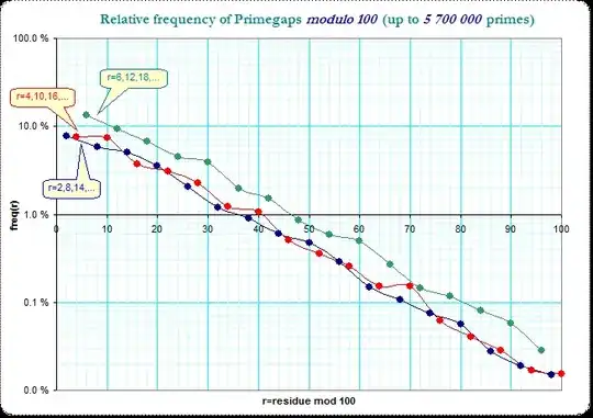

It might also be interesting to see that primegap-frequencies separated into three subclasses - :
That trisection shows the collected residue classes $6,12,18,...$ (the green line) as dominant over the two other collections and the two other collection change "priority" over the single residue classes.
The modulo-10-problem overlays that curves a bit and irons the variation a bit out and even makes it a bit less visible - but not completely: because the general distribution of residue classes in the primegaps has such a strong dominance in the small residue-classes. So I think that general distribution-characteristic explains that modulo-10 problem, however a bit less obvious...

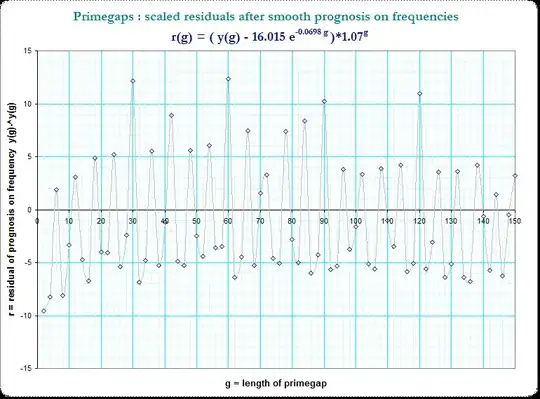

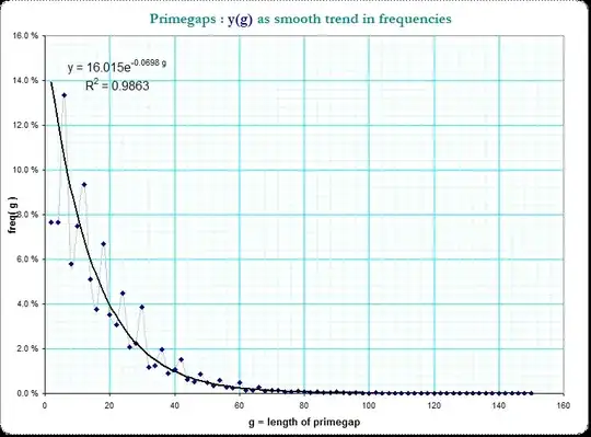

2. Further observations (update 2)
For further analysis of the remaining jitter in the previous image I've tried to de-trend the frequencies distribution of the primegaps (however now without modulo considerations!).
Here is what I got on base of 5 700 000 primes and the first 75 nonzero lenghtes g. The regression-formula was simply created by the Excel-spreadsheet: image_trend
De-trending means to compute the difference between the true frequencies $\small f(g)$ and the estimated ones; however, the frequency-residuals $\small r_0(g)=f(g) - 16.015 e^{-0.068 g }$ decrease in absolute value with the value of g. Heuristically I applied a further detrending function at the residuals $\small r_0(g)$ so that I got $\small r_1(g) = r_0(g) \cdot 1.07^g $ which look now much better de-trended.
This is the plot of the residuals $\small r_1(g)$:
image_resid

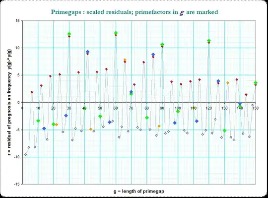

Now we see that periodic occurences of peaks in steps of 6 and even some apparent overlay. Thus I marked the small primefactors $\small (3,5,7,11)$ in g and we see a strong hint for a additive composition due to that primefactors in $g$
image_resid_primefactors
The red dots mark that g divisible by 3, green dots that by 5, and we see, that at g which are divisible by both the frequency is even increased.
I've also tried a multiple regression using that small primefactors on that residuals, but this is still in process....

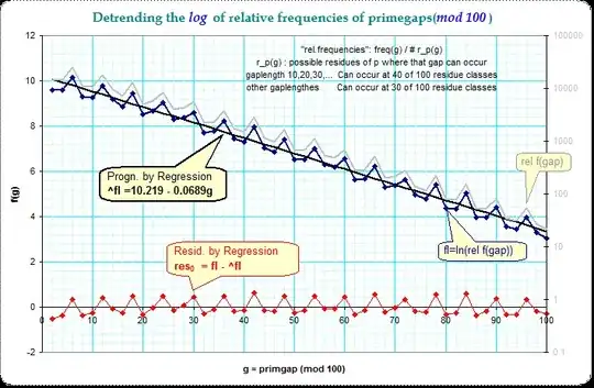

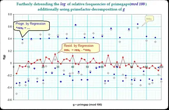

3. observations after Regression/Detrending (update 3)
Using multiple regression to detrend the frequencies of primegaps by their length g and additionally by the primefactors of g I got initially a strong surviving pattern with peaks for the primefactor 5. But those peaks could be explained by the observation, that (mod 100) there are 40 residues of primefactor p where the gaplength g=0 (mod 10) can occur, but only 30 residues where the other gaplengthes can occur.
Thus I computed the relative (logarithmized) frequencies as $\text{fl}(g)=\ln(f(g)/m_p(g))$ where $f(g)$ is the frequency of that gaplength, and $m_p(g)$ the number of possible residue classes of the (first) prime p (in the pair (p,q) ) at where the gaplengthes g can occur.
The first result is the following picture where only the general trend of decreasing of frequencies of larger gaps is detrended:
picture_regr_1
This computation gives a residue $\text{res}_0$ which is the relative (logarithmized) frequency after the length of the primegap is held constant (see the equation in the picture). The regular pattern of peaks at 5-steps in the earlier pictures is now practically removed.
However, there is still the pattern of 3-step which indicates the dominance of gaplength 6. I tried to remove now the primefactorization of g as additional predictors. I included marker variables for primefactors q from 3 to 29 into the multiple regression equation and the following picture shows the residues $\text{res}_1(g)$ after the systematic influence of the primefactorization of g is removed.
picture_regr_2
This picture has besides a soft long hill-like trend no more -for me- visible systematic pattern, which would indicate non-random influences.
(For me this is now enough, and I'll step out - but still curious whether there will come out more by someone else)
