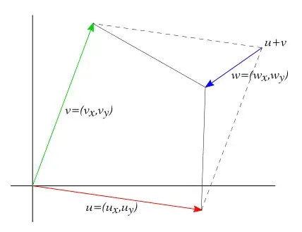

There is a kind of transformation that is not linear but it is simple and fits the job. It allows you to transform the unit square into an arbitrary quadrilateral.
$$\pmatrix{x'\\y'} = \pmatrix{u_x&v_x&w_x\\u_y&v_y&w_y}\pmatrix{x\\y\\xy}$$
$$x'=u_xx+v_xy+w_xxy\\ y'=u_yx+v_yy+w_yxy$$
It transforms the unit square in a way controlled by the vectors $u=(u_x,u_y), v=(v_x,v_y), w=(w_x,w_y)$ as follows:
Geometric interpretation of u, v, w
Note however that it's not a perspective transformation.
