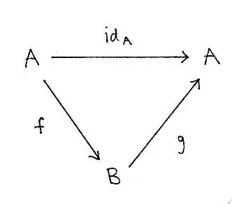

Let $f:A \to B$ , $g:B \to A$, and $\operatorname{id}:A \to A$ be the identity. If the diagram
$\hspace{4cm} $ enter image description here
commutes, prove that ${ f}$ is one-one and ${ g}$ is onto.
THEOREM If the diagram above commutes, then $ f$ is one-one and $g$ is onto.
PROOF The commutativity of the diagram implies that
$${g f}(x)=x \;; \forall x\in A$$
thus $gf $ is one-one and onto.
$(1)$ $ f$ is one-one. Assume that ${ f}(x)={ f}(y)$.Then
$${ f}(x)={ f}(y)$$
$${ gf}(x)={ gf}(y)$$
$$x=y$$
so that $ { f}$ is one-one.
$(2)$ $g$ is onto. If it wasn't the case $gf $ wouldn't be onto, which is impossible.
I don't know wether the last "proof" is right. I can see why it must be the case but I'm not able to exlain it and give a clear proof like that of $f$ being one-one which seems very clear.

    An absolutely watertight way to prove that $g$ is onto to take $a\in A$, and show that there is a $b\in B$ for which $g(b)=a$, and this should not be hard to find ... – Old John Jul 06 '12 at 19:33
  • For sure, $f(A)\subseteq B$. – Sigur Jul 06 '12 at 19:37
  • @Sigur Sorry, yes. I was overthinking it too much! – Pedro Jul 06 '12 at 19:38
  • Start with $a\in A$ (on the right of the diagram). Then pull back to $a\in A$ on the left of the diagram. Then apply $f$ to this element $a$, – Old John Jul 06 '12 at 19:38
  • we know $gf(a) = a$. thus, for any $a \in A$, $b = f(a)$ is the element we seek. – David Wheeler Jul 06 '12 at 19:40
  • @DavidWheeler I had written that, but I wasn't sure. I sometimes overtink this results that are almost tautological, and in this case I was worrying about $f$ being onto or not, because I was thinking about $a$ in the west-side $A$ and not in the east-side $A$. Thanks anyways. – Pedro Jul 06 '12 at 19:43
    You might find helpful this post. – Bill Dubuque Jul 06 '12 at 19:43

For $a\in A$, take $b=f(a)\in B$ such that $g(b)=g(f(a))=a$.
