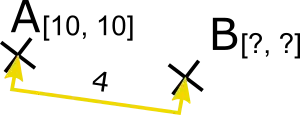

I have two points, for which I know Cartesian coordinates. I want to move one towards the other over specific distance.
image description
That's about the same as saying I want the distance between the points equal to specific value:
image description
How do I achieve that? I think it's the basic in any game and vector operations, moving Cartesian point towards specific location...
