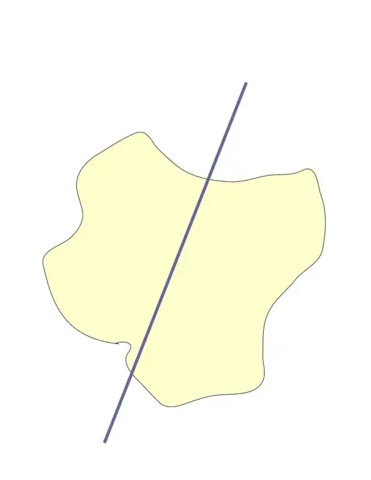

Squiggly or blobby higher-dimensional shapes are called "manifolds", by the way.line splitting a blob in 2-D
