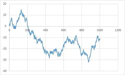

  1. There are two theorems that will help deciding about this power series. One is Weyl's saying about the condition that any series is equidistributed, and another Hardy and Littlewood saying that power series (like ours) with almost all real numbers (almost all means with some exceptions like integers, golden ratio and so on) is equidistributed.
So, we are either within almost all or we are an exception.
Weyl is saying to calculate for all positive integers $p$ this and to check if the limit tends to $0$.
$$\lim\limits_{m \to \infty} \frac{1}{m} \sum\limits_{n=1}^{m} e^{2\pi i p \pi^n}$$
We will satisfy ourselves with calculating real part of it, for $p=1$ and without reciprocal.
$$\sum\limits_{n=1}^{m} \cos(2\pi^{n+1})$$
Without further ado here is the plot for $n<1000$. The sum stays well beyond $n$ so if we divide it as the limit requires it will probably start reaching $0$. We do know that most of the numbers are normal in this sense, but we have a strong headache when we try to resolve any single one of them like $\pi^n$ or $e^n$.
Even if we ignore this and take that it is equidistributed, do not use $\{\pi^n\}$ as a random generator in interval $(0,1)$. It will not pass various random tests.
Weyl's criterion for $\pi$ power sequence
