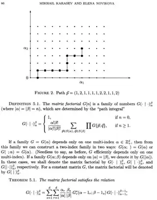

I could find the following references that take the use of matrix factorial for a concrete applied context:
Coherent Transform, Quantization and Poisson Geometry: In his book Mikhail Vladimirovich Karasev uses for example the matrix factorial for hypersurfaces and twisted hypergeometric functions.
