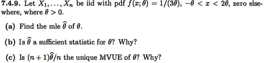

Trying to solve the task from above, I'm having trouble with solving the last part. My idea was to find both $E[-Y_1]$ and $E[\frac{Y_n}{2}]$ and show, that both are equal to $\frac{n}{n+1}\theta$. The answers provided by the book say, that $\frac{n+1}{n} \hat\theta$ is the MVUE of $\theta$.
My calculations lead me to completely another answer, I'm wondering if there is a typo in the book, or if my calculations are bad. Tried to find mistake, but couldn't. Or maybe the method is completely wrong for some reason, that I don't see?
For those brave enough, to go through my calculations, here they are.
Thanks in advance for all Your help.

For anybody, that would have simmilar problem. You need to get the distribution of $\hat\theta$ and then get expected value based on that.
