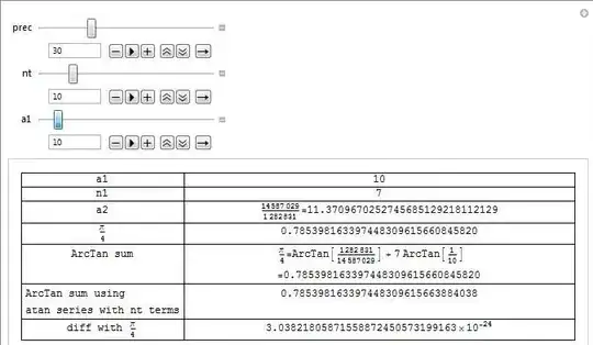

Here is the Mathematica code where you can see that even with small $a1$ value ($a1=10$) and using only $nt=10$ terms to compute the classic $arctan$ series $(2)$, you already get a $10^{-24}$ precision result:
pi/4 code

So as $a1$ goes to Infinity, the result gets closer to $\pi/4$.
You can also increase the number of steps used to compute the classic $arctan$ series (see formula $(2)$), number corresponding to the $nt$ variable in the above code, which drastically improves the result.
For what I know, the formula seems pretty efficient to get a $\pi$ approximation when using larger $a1$ value, even if you're using only a few terms to compute the $arctan$ series.
So finally my question: is this kind of formula already known? Also, how can I evaluate the formula's efficiency? To say the truth, I don't see why formulas with more $arctan$ terms should be more efficient: with this formula, you can arbitrarily choose the precision by choosing larger $a1$ value (which also guarantees that $arctan(1/a2)$ will be smaller than $arctan(1/a1)$), as of course the number of terms used to compute the $arctan$ series. So theoretically, we could get a better formula than any existing Machin's formula...
