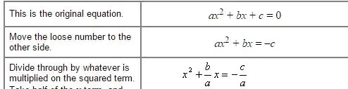

I cannot understand how quadratic formula to solve for $x$ was derived.
On this website, it explains the steps
Following I understand
but I cannot understand how they got
$b/2a$
and why they are squaring it
$b^2/4a^2$
Really, I am baffled!

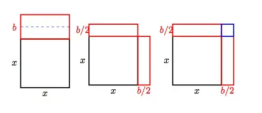

Hint:
This is the completing the square trick. Usefull in many other cases and simple to visualize.
The black square is $x^2$, the red rectangle is $bx$, so $x^2+bx$ can be transformed to a square adding the little blue square, that is $(b/2)^2$.
