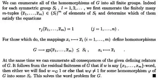

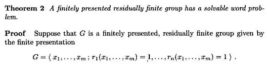

One can prove quite simply a much more general result due to McKinsey, viz. alt text alt text
Bill Dubuque
  • 272,048

    I don't understand this proof. How do we know when to stop searching for a $\phi$ such that $\phi(w)\ne1$? – Christopher Hughes Jan 22 '20 at 21:36
    @ChristopherHughes: In general, with such an old question, it's usually best to ask followup questions in a new post, linking to the old post. In this case it's simple enough to explain though: you stop searching for $\phi$ when you prove that $w$ represents the identity, i.e. when your enumeration of the consequences of the defining relators comes up with the consequence that $w=_G 1$. – Lee Mosher Jan 24 '20 at 14:15
