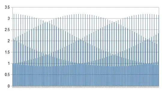

$$x_{n+1} = \frac{c + x_n}{x_{n-1}},\; x_1 = x_0 = 1 \qquad \textrm{for } c > 0$$
For $c=1$ the sequence is periodic with period 5 and range {1,2,3}. For other values of $c$ the sequence appears to be oscillatory. For small $c$, the supremum seems to be slightly more than $1+2c$, while for larger $c$ it seems to approach $3c$.
Is there a simple formula for the bounds of the sequence in this general case? What about the range? Are the sequences periodic? Are they dense within the bounds?

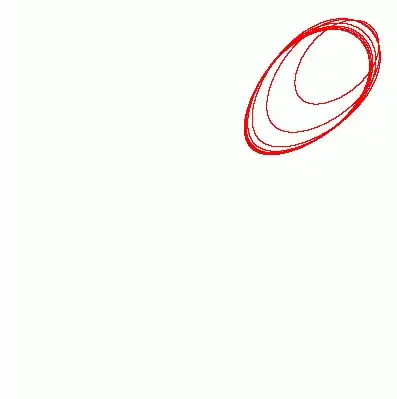

c = 1.1

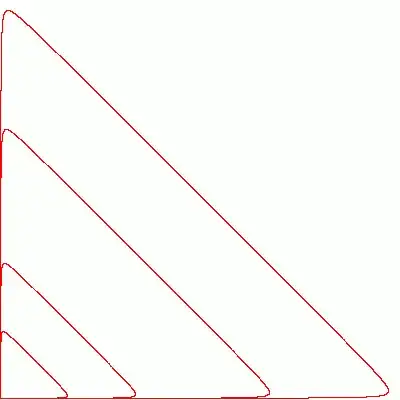

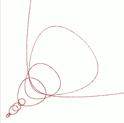

Computational evidence suggest the following conjectures.
For $1\ne c>0$ a sequence $\{z_n\}=\{(x_n,x_{n+1})\}$ is a dense set of a smooth curve which bounds a convex shape. When $c$ tends to infinity this shape tends to an isosceles right angled triangle with sides of order $c$, when $c$ tends to zero the shape tends to an ellipse, see the graphs.
$c=2^{-2}, 2^{-1},\dots, 2^7$ (I remark that the diameter of the shape is not a monotone function of $c$):
$c=2^{8}, \dots, 2^{11}$:
$c=2^{-3}, \dots, 2^{-22}$:
