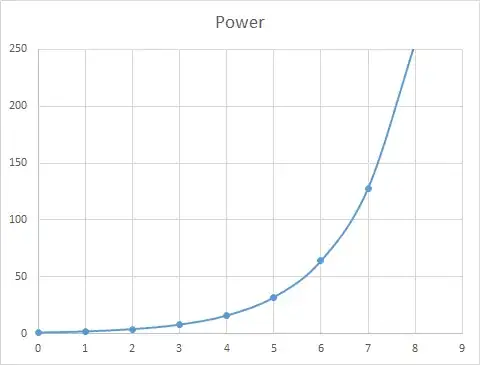

For the sake of illustration, I have made a plot of the powers of $2$ (those of $10$ grow too fast). enter image description here
You see that they nicely align on a smooth and regular curve. Then it is a natural thing to define the powers for non-integer numbers too. And by continuity of the curve, for every number $y$, there will be some $x$ such that $y=2^x$.
How exactly we can compute these is another matter, but here is a hint: it is easy to show that $\sqrt{2^{2n}}=2^n$. Then, we can generalize to real $x$ by admitting $\sqrt{2^x}=2^{x/2}$. This tells us $2^{0.5}=\sqrt{2}, 2^{1.5}=2\sqrt2,2^{0.25}=\sqrt{\sqrt{2}},2^{0.75}=\sqrt{\sqrt{2}}\sqrt{2}\cdots$
