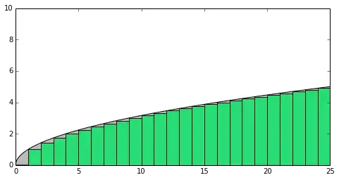

To give you a sense of how much we are losing on this approximation, let's draw two pictures.
We are losing all the gray stuff in our approximation, which is quite a lot! I don't really care about the integral, what's important is the difference between all the stuff we are adding and square root of $n$.

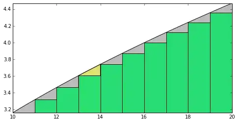

The yellow triangle has base $1$ and height $\sqrt{14} - \sqrt{13}$ so the area is:
$$ A = \frac{1}{2} \times b \times h = \frac{1}{2} \times 1 \times (\sqrt{\color{#E0E070}{14}} - \sqrt{\color{#E0E070}{13}}) = \frac{1}{2}(\sqrt{n+1} - \sqrt{n}) \approx \frac{1}{4 \sqrt{n}}$$
This suggests the total of all errors is about $\propto \sqrt{\color{#D22}{n}}$ which is not a small amount. Can anyone get the constant of proportionality?

  • Indeed, if we add up the area of the $\color{#20E070}{\text{green}} $ rectangle and the $\color{#E0E070}{\text{yellow}}$ triangle, we do get a trapezium, whose area is $A = \frac{1}{2} \times b \times (h_1 + h_2)$. – cactus314 Nov 16 '15 at 18:03
