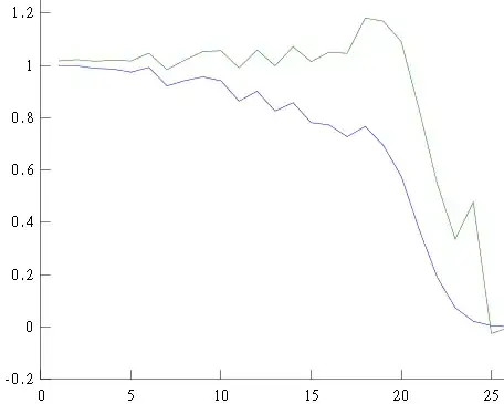

is actually an upper bound. One can also add a small correction term (slightly better approximation, but now it's not a strict bound) but substracting $1/2$ in the inner summation (to account for the low-rounding effect of the floor function). Then we get
$$N(n,k) \approx \frac{3}{2} + (n-k) S_k - 2^{k-1} \tag{2}$$
this improves the approximation for medium values of $k$. Here's an graph of the ratio of the exact value over the approximation (1) (blue) and (2) (green), for $n=30$.
