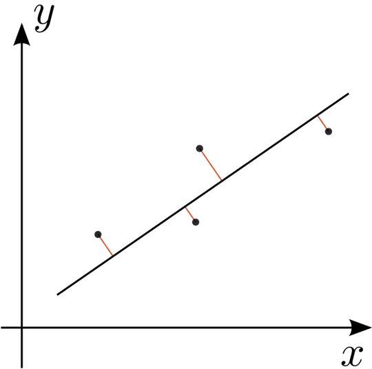

With appropriate method names, you will be able to find a lot of references: you seem to be looking for Deming regression, orthogonal regression, orthogonal distance regression (ODR), errors-in-variables (EIV) modeling, or more often total least squares (TLS). It is illustrated below in the bivariate case:
The model was originally introduced by R. J. Adcock, 1878, A problem in least squares, refined by C. H. Kummell, 1879, Reduction of observation equations which contain more than one observed quantity, and revived by W. E. Deming, 1943, Statistical adjustment of data.
