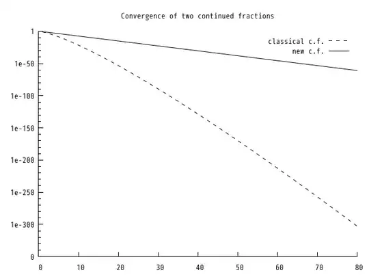

Here is a plot showing the convergence of the continued fraction compared to the classical one for $\tanh$. The abscissa is the rank of the convergent (the last value of $n$ in the formula above):

  • What does represent the vertical axes in the plot? $tanh(x)$ when $x$ is large? How large? If you just want to put a single plot, instead of plotting for just one value of $x$, It would be better to plot the MSE over a large number of values of $x$, for example 10000 equispaced values in $[-13, 13]$. If $y_i = tan(x_i)$ and $\hat {y}_i = f(x_i)$, where $f$ is your new expression, then the MSE could be computed as
    $$\text{MSE} = \frac{1}{N}\sum_{i=1}^{N} (y_i - \hat{y}_i)^2$$
    – Carlos H. Mendoza-Cardenas Nov 16 '15 at 12:40
  • @Carlos Mendoza Sorry for that; vertical axes is log(abs(tanh(1)-K(1,n))) where K(x,n) is continued fraction evaluated at x up to rank n, in other words K(x,n) is the nth convergent of the continued fraction for x=1. As said in the post, n being itself the horizontal axes. – Thomas Baruchel Nov 16 '15 at 14:50
