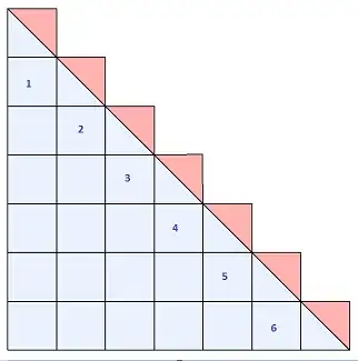

Here's a proof without words that should help, just generalize from there.
Zach466920
  • 8,341
