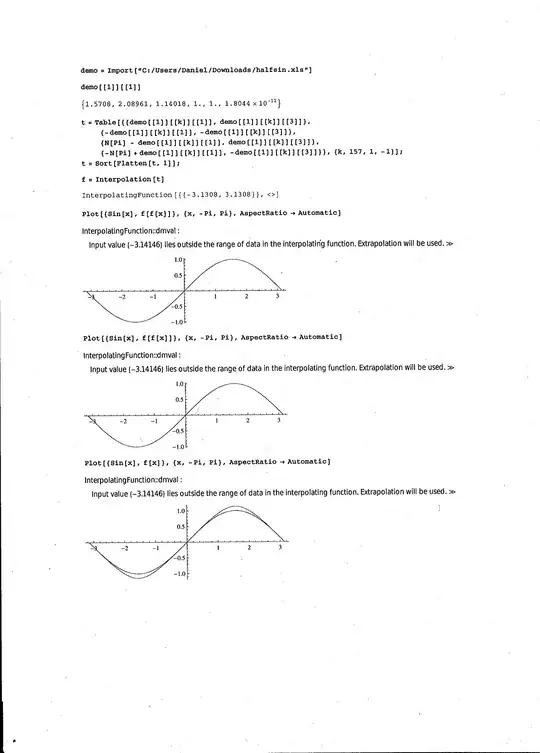

Finally, the hardest bit is when the fixpoint has derivative $1.$ I spent quite a bit of time finding a half-iterate for $\sin x.$ It works, the result is in between the sine wave and a sawtooth curve (of line segments) that is tangent to the sine curve at multiples of $\pi.$ And, for $0 < x < \pi,$ it is real analytic. I wrote to Jean Ecalle, it turns out that the function really is $C^\infty$ when we expand to include $x=0,$ therefore $C^\infty$ on the entire real line. Let's see, amplitude a little larger than $\sin x$ itself, not as large as the sawtooth; $\pi/2 \approx 1.570796,$ and we get $f_{1/2} (1.570796) \approx 1.140179.$
The (substantial) work is summarized at https://mathoverflow.net/questions/45608/formal-power-series-convergence/46765#46765

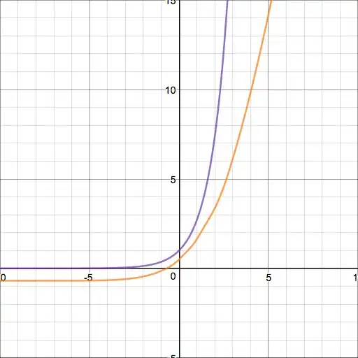

This question already has a great answer, but I thought that you might like to see an actual piecewise construction of such a function (defined on $(-\ln(2),\infty)$). My function is not analytic, but it is continuous and differentiable on $\mathbb R$.
First notice that if we find a function $h$ with the property $$(h\circ h)(x)=e^x$$ then it follows that $$(h^{-1}\circ h^{-1})(x)=\log(x)$$ and we may use $h^{-1}=\text{sog}$.
Okay, this piecewise definition gets a bit gross, so bear with me.
Define a sequence $a_n$ as follows: $$a_{-1}=-\log(2),\space\space a_0=0$$ $$a_{n+2}=\exp(a_n)$$ and define a sequence of functions $H_n$ as follows: $$H_{-2}(x)=\log(e^x+0.5)$$ $$H_{n+1}(x)=\exp(H^{-1}_n(x))$$ Then one may show verify rather simply that the function $$h(x) = \left\{ \begin{array}{lr} H_{-2}(x) & : -\infty \lt x \le -\log(2)\\ H_n(x) & : a_n\lt x \le a_{n+1} \end{array} \right.\\$$ satisfies $(h\circ h)(x)=e^x$. If it helps, I can write the definition out for you this way: $$h(x) = \left\{ \begin{array}{lr} \ln(e^x+0.5) & : -\infty \lt x \le -\log(2)\\ e^x-0.5 & : -\log(2)\lt x \le 0\\ x+0.5 & : 0\lt x \le 0.5\\ e^{x-0.5} & : 0.5\lt x \le 1\\ \text{etc}...\\ \end{array} \right.\\$$ With a bit more difficulty (and induction), one may prove that it is differentiable on $\mathbb R$ (unfortunately, it is not twice differentiable). Here is a its graph (in orange) alongside a graph of $y=e^x$ (in purple):

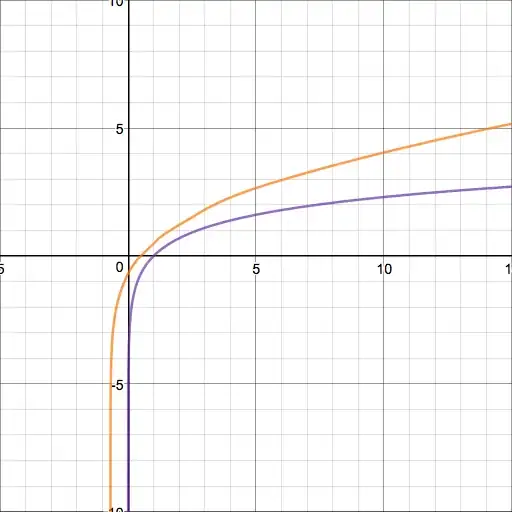

Now, for $\text{sog}(x)$, all we need to do is graph $y=h^{-1}(x)$:

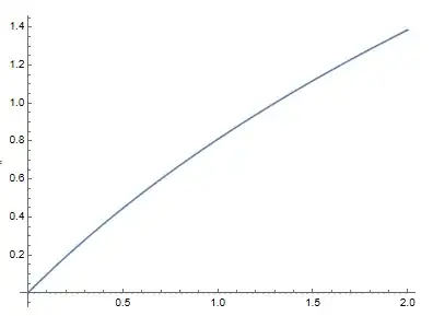

The usual way to calculate fractional iterations of functions is to use Newton's series as described here:
$$f^{[s]}(x)=\sum_{m=0}^{\infty} \binom {s}m \sum_{k=0}^m\binom mk(-1)^{m-k}f^{[k]}(x)$$
For the function $\ln x$ the series diverges, but if you take $\ln(x+1)$ it works fine, for instance, here is the half-iteration of $\ln(x+1)$ using this series:
Mathematica code:
n := 50
it := 0.5
func := Function[x, Log[x + 1]]
iter[k_Integer, x_] := Nest[func, x, k]
Iter[x_, i_] :=
 Sum[Binomial[i, m]*
   Sum[(-1)^(k - m)*Binomial[m, k]*iter[k, x], {k, 0, m}],
     {m, 0, n}]
ReImPlot[{Iter[x, it]}, {x, 0, 2}, AspectRatio -> Automatic]
