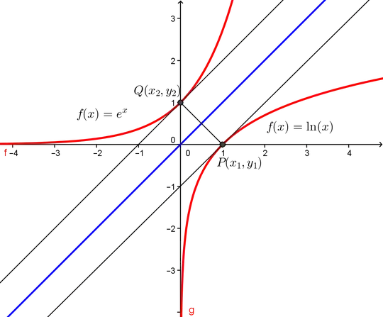

How to find the minimum distance between the two curves $e^x$ and $\ln (x)$ ?
No idea how to find the common normal in this case.Help!

    Consider that the two curves are reflections of one another across the line $y = x$. Then convince yourself that at the closest approach of the curves, the tangents to each curve should be parallel to this line (and the normals perpendicular). This should allow you to locate the pair of points on the curve that minimize the distance. – Dylan Murphy Oct 27 '15 at 16:50

Hint:
  • Each graph forms the boundary of a convex region. The line segment of minimal distance between the two curves must therefore be unique.
  • The picture is symmetric about the line $y = x$, so reflecting the line segment through this line must yield another line segment of minimal length.
We can deduce that the slope of the common normal must therefore be $-1$.

Minimum Distance between Two curve is Distance between two parallel tangents
drawn at point $P$ and $Q$ on the curves.
and Here $f(x)=e^x$ and $f(x)=\ln(x)$ are Inverse of each other .
So it is Symmetrical about $y=x$ Line.
Let We take any point $P(x_{1},y_{1})$ on $f(x) = \ln(x)\;,$ Then Slope of tangent at $P(x_{1},y_{1})$ to the curve
$f(x)=\ln(x)$ is $\displaystyle f'(x_{1})=\frac{1}{x_{1}}$ and Slope of line $f(x)=x$ is $f'(x)=1$
Now If line $f(x)=x$ and Tangent at point $P(x_{1},y_{1})$ to the curve are parallel.
Then $\displaystyle \frac{1}{x_{1}} = 1\Rightarrow x_{1}=1$ Now We get $y_{1}=f_{x_{1}}=\ln(1) =0$
So we Get Coordinate of $P(1,0)$
Now Distance between Line $x-y=0$ from $P(1,0)$ is $\displaystyle = \frac{1}{\sqrt{2}}$
So $PQ = 2\times $ of Distance of line from $\displaystyle P(1,0) = \frac{2}{\sqrt{2}}=\sqrt{2}$ Unit.

  • @KeithMcClary Analytically, one wants to minimize $$f(x,u)=(e^x-\ln u)^2+(u-x)^2$$ over $x$ real and $u$ positive real. Computing the gradient of $f$ and reordering somewhat the equations, one sees that this can only happen when $$e^x=\frac1u\qquad \ln u=\frac{1-u^3}{u+u^2}.$$ The sign of the last fraction shows the second equation holds only when $u=1$, then the first equation yields $x=0$, then $f(0,1)=2$ is the square of the distance between the two curves, QED. – Did Oct 29 '15 at 10:53
