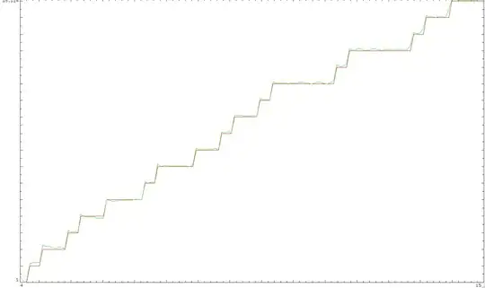

In a paper about Prime Number Races, I found the following (page 14 and 19):
This formula, while widely believed to be correct, has not yet been proved. $$ \frac{\int\limits_2^x{\frac{dt}{\ln t}} - \# \{\text{primes}\le x\} } {\sqrt x/\ln x} \approx 1 + 2\sum_{\gamma} \ \ \frac{\sin(\gamma\ln x)}{\gamma}, \tag{3} $$ with $\gamma$ being imaginary part of the roots of the $\zeta$ function.
$\dots$
For example, if the Generalized Riemann Hypothesis is true for the function $L(s)$ just defined, then we get the formula $$ \frac{\#\{\text{primes}\ 4n+3 \le x\} - \#\{\text{primes}\ 4n+1 \le x\}} {\sqrt x/\ln x} \approx 1 + 2\sum_{\gamma^\prime} \frac{\sin(\gamma^\prime\ln x)}{\gamma^\prime}, \tag{4'} $$ with $\gamma^\prime$ being imaginary part of the roots of the Dirichlet $L$-function associated to the race between primes of the form $4n+3$ and primes of the form $4n+1$, which is $$ L(s) = \frac1{1^s} - \frac1{3^s} + \frac1{5^s} - \frac1{7^s} + \dots. $$
  1. Since $$ \begin{eqnarray} \# \{\text{primes}\le x\} &=&\# \{\text{primes}\ 4n+3 \le x\} + \#\{\text{primes}\ 4n+1\le x\}\\ &\approx& \text{Li}(x)- \left(\sqrt x/\ln x\right) \left(1 + 2\sum_{\gamma} \ \ \frac{\sin(\gamma\ln x)}{\gamma} \right) \end{eqnarray} $$ and assuming the (Generalized) Riemann Hypothesis to be true, is it valid to calculate $$ \begin{eqnarray} \# \{\text{primes}\ 4n+3 \le x\} &\approx& \frac{\text{Li}(x)}{2} &-& \frac{\left(\sqrt x/\ln x\right)}{2} \left(1 + 2\sum_{\gamma} \ \ \frac{\sin(\gamma\ln x)}{\gamma} \right)\\ &&&+& \frac{\left(\sqrt x/\ln x\right)}{2} \left( 1 + 2\sum_{\gamma^\prime} \frac{\sin(\gamma^\prime\ln x)}{\gamma^\prime} \right)\\ &\approx& \frac{\text{Li}(x)}{2} &+& \left(\sqrt x/\ln x\right) \left(\sum_{\gamma^\prime} \frac{\sin(\gamma^\prime\ln x)}{\gamma^\prime} -\sum_{\gamma} \ \ \frac{\sin(\gamma\ln x)}{\gamma} \right), \end{eqnarray} $$ or do the error terms spoil the calculation?
  2. Is there another way to get $\# \{\text{primes}\ 4n+3 \le x\}$ using a different Dirichlet $L$-function? How does it look like? Is it possible to treat the general case of $\# \{\text{primes}\ kn+m \le x\}$ the same way?
EDIT From the wiki page on Generalized Riemann hypothesis (GRH), I get:
Dirichlet's theorem states that if a and d are coprime natural numbers, then the arithmetic progression a, a+d, a+2d, a+3d, … contains infinitely many prime numbers. Let π(x,a,d) denote the number of prime numbers in this progression which are less than or equal to x. If the generalized Riemann hypothesis is true, then for every coprime a and d and for every ε > 0 $$ \pi(x,a,d) = \frac{1}{\varphi(d)} \int_2^x \frac{1}{\ln t}\,dt + O(x^{1/2+\epsilon})\quad\mbox{ as } \ x\to\infty $$ where φ(d) is Euler's totient function and O is the Big O notation. This is a considerable strengthening of the prime number theorem.
So my example would look like $$ \pi(x,3,4) = \frac{1}{\varphi(4)}\text{Li}(x) + O(x^{1/2+\epsilon}), $$ (something that already ask/answered here: Distribution of Subsets of Primes). So the part with the roots seems to be burried in $O(x^{1/2+\epsilon})$, since $\varphi(4)=2$.
Thanks...
draks ...

Here is how far I got with an explicit formula for the number of primes of the form $4n+3$ below $x$, $\pi^*(x;4,3)$, expressed in terms of (sums of) sums of Riemann's $R$ functions over roots of Riemann's $\zeta$ resp. Dirichlet $\beta$ function:
\begin{align*} \Pi^*(x;4,3) &= \pi^*(x;4,3) + \tfrac12 \sum_{\substack{b\pmod 4 \\ b^2\equiv 3\pmod 4}} \pi^*(x^{1/2};4,b) + \tfrac13 \sum_{\substack{c\pmod q \\ c^3\equiv 3\pmod 4}} \pi^*(x^{1/3};4,c) + \cdots \\ \end{align*} Then I try to complete things by adding several up
\begin{align*} \Pi^*(x;4,3) &= \tfrac11\pi^*(x;4,3) + \tfrac13 \pi^*(x^{1/3};4,3) + \cdots \\ \tfrac12\Pi^*(x^{1/2};4,3) &= \tfrac12\pi^*(x^{1/2};4,3) + \tfrac16 \pi^*(x^{1/6};4,3) + \cdots \\ \tfrac14\Pi^*(x^{1/4};4,3) &= \tfrac14\pi^*(x^{1/4};4,3) + \tfrac1{12} \pi^*(x^{1/12};4,3) + \cdots \\ &\vdots&\\ \hline\\ \tag{1}\sum_{k=0}^\infty 2^{-k}\Pi^*(x^{2^{-k}};4,3)&=\sum_{m=1}^\infty \tfrac1m \pi^*(x^{1/m};4,3) \end{align*} Using Möbuis inversion I'll get
\begin{align*} \pi^*(x;4,3)&=\sum_{m=1}^\infty \tfrac{\mu(m)}m\sum_{k=0}^\infty 2^{-k}\Pi^*(x^{2^{-k}/m};4,3)\\ \tag{2}&=\sum_{k=0}^\infty 2^{-k}\sum_{m=0}^\infty \tfrac{\mu(m)}m\Pi^*(x^{2^{-k}/m};4,3) \end{align*} Now I use
\begin{align*} \Pi^*(x^{2^{-k}};4,3)&=\frac1{\phi(4)} \sum_{\chi\pmod 4} \overline{\chi(3)}\Pi^*(x^{2^{-k}},\chi)\\ \tag{3}&=\frac12 \left( \Pi^*(x^{2^{-k}},\chi_1)- \Pi^*(x^{2^{-k}},\chi_2) \right) \end{align*} and then
\begin{align*} \tag{$4_1$}\Pi^*(x^{2^{-k}},\chi_k)&=\operatorname{li}(x^{1/2^{k}})-\sum_{\rho_\zeta} \operatorname{li}(x^{\rho_\zeta/2^k})\text{ if $k=1$}\\ \tag{$4_2$}&=\phantom{\operatorname{li}(x^{1/2^{k}})}-\sum_{\rho_\beta} \operatorname{li}(x^{\rho_\beta/2^k})\text{ if $k=2$}\\ \end{align*} which gives
\begin{align*} \tag{3'}\Pi^*(x^{2^{-k}};4,3)&=\frac12 \left( \operatorname{li}(x^{1/2^{k}})-\sum_{\rho_\zeta} \operatorname{li}(x^{\rho_\zeta/2^k}) +\sum_{\rho_\beta} \operatorname{li}(x^{\rho_\beta/2^k}) \right) \end{align*} so finally
\begin{align*} \pi^*(x;4,3)&=\sum_{k=0}^\infty 2^{-k}\sum_{m=0}^\infty \tfrac{\mu(m)}m\frac12 \left( \operatorname{li}(x^{1/2^{k}})-\sum_{\rho_\zeta} \operatorname{li}(x^{\rho_\zeta/2^k}) +\sum_{\rho_\beta} \operatorname{li}(x^{\rho_\beta/2^k}) \right)\\ \tag{5}&=\sum_{k=0}^\infty 2^{-k-1}\left( \operatorname{R}(x^{1/2^{k}})-\sum_{\rho_\zeta} \operatorname{R}(x^{\rho_\zeta/2^k}) +\sum_{\rho_\beta} \operatorname{R}(x^{\rho_\beta/2^k}) \right) \end{align*}
I would be very, very glad to read your opinion...

UPDATE: The point of this answer is to visualize your exact formula for the prime counting function restrained to primes $\equiv 3 \bmod 4$. The sums over $\rho_\zeta$ and over $\rho_\beta$ are over all the zeros of the Riemann-$\zeta$ and Dirichlet-$\beta$ functions respectively sorted by increasing absolute imaginary part :
$$\pi_{Dr}(x):=\sum_{k=0}^\infty\;2^{-k-1}\left( \operatorname{R}\left(x^{1/2^{k}}\right)-\sum_{\rho_\zeta} \operatorname{R}\left(x^{\rho_\zeta/2^k}\right) +\sum_{\rho_\beta} \operatorname{R}\left(x^{\rho_\beta/2^k}\right) \right)-1$$
(I subtracted $1$ at the end as found necessary by this other derivation using your nice telescoping method)
The plot of the approximation obtained by truncating the infinite series to their first terms (the parameters used are indicated at the end) is compared to the exact (darker) formula for $\pi_{4,3}(x)$ with $x\in (4,150)$ (the picture may be zoomed) :
comparison over 4-150
Such a picture doesn't constitute a proof but merits my sincere < Felicitations !>

// pari/gp scripts //
\r zeta.gp
tz=%;
\r beta.gp
tb=%;
;Ei(z)=-eint1(-z)+Pi*I*sign(imag(z))  ;correct formula provisory replaced by :
Ei(z)=if(abs(imag(z))<20,Pi*I*sign(imag(z))-incgam(0,-z),local(n=5+round(1000/(abs(imag(z))+1e-8)),r=-z);forstep(k=n,1,-1,r=-z+k/(1+k/r));-exp(z)/r)+Pi*I*sign(imag(z))
R(n,lx)=sum(k=1,n,moebius(k)*Ei(lx/k)/k)
pi43(x)=local(c=0);forprime(p=3,x,if(p%4==3,c++));c
piDr(n,r,p,x)=local(lx=log(x));sum(k=0,p,2^(-k-1)*(R(n,1/2^k*lx)+2*sum(i=1,r,-R(n,(1/2+tz[i]*I)/2^k*lx)+R(n,(1/2+tb[i]*I)/2^k*lx))))-1
// 'short' session using these functions //
> pi43(100)
= 13
> piDr(20,100,6,100)
= 13.640816983 + 0.6262904416*I
> ploth(x=4,150,[real(pi43(x)),real(piDr(20,330,10,x))],,146)

  • Raymond, thank you so much. I'm very happy that this (the formula) worked out that well. Thanks also for the PARI scripts. Just yesterday I tried to start with it and now you gave me such nice example to work with and to learn. – draks ... Jun 06 '13 at 09:29
  • Glad you liked it @draks ! To make it more useful I had to speed up $\operatorname{Ei}$ and succeeded simply by replacing pari's native implementation of the $E_1$ function ('eint1' limited to real values) by the more general incomplete gamma function ('incgam' that works for all complex values at least in my release $2.6.0$) using $,E_{\nu}(z)=z^{\nu-1},\Gamma(1-\nu,z),$ with $\nu=1$. The result is that the plot was obtained in a little more than $5$ minutes instead of $3,5$ hours. Not bad ! :-) Fine continuation ! – Raymond Manzoni Jun 07 '13 at 22:59
  • Btw there is a bug in the incgam() function implementation in pari (I submitted a bug report). To limit the error in the meantime use a lower precision of 19 digits with \p 19 (or 9) or the C.F. method in my initial answer when the absolute value of the imaginary part is larger than (say) $20$. – Raymond Manzoni Jun 09 '13 at 16:54
  • @draks: I updated my answer in the other thread. It seems that the shift was of $1$ and probably due to the missing prime $2$. (I'll update my answer here later). Concerning the pari/gp formula I use Ei(z)=if(abs(imag(z))<20,PiIsign(imag(z))-incgam(0,-z),local(n=5+round(1000/(abs(imag(z))+1e-8)),r=-z);forstep(k=n,1,-1,r=-z+k/(1+k/r));-exp(z)/r)+PiIsign(imag(z)) (until the pari bug is solved). – Raymond Manzoni Jun 11 '13 at 23:52
  • Raymond, it looks amazing. Thanks for all your support. I'm a little busy with other things these days, but, at least for me, the story doesn't end here. I've got more questions... BTW: sorry for the late reply. I was on vacation. – draks ... Jun 17 '13 at 21:29
  • No problem @draks. Excellent come back !:-) – Raymond Manzoni Jun 17 '13 at 22:50
