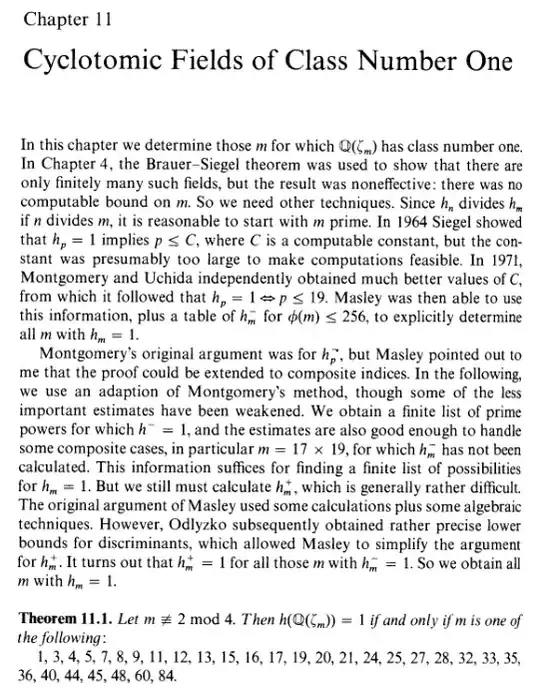

Edit: Apparently the full list of cyclotomic fields with class number $1$ is known! Here is the first page of chapter 11 from Washington's Introduction to Cyclotomic Fields:
(Note that the restriction $m\not\equiv2\bmod 4$ is just to get rid of unnecessary duplicate information, since if $m\equiv 2\bmod 4$ then $\mathbb{Q}(\zeta_m)=\mathbb{Q}(\zeta_{m/2})$.)
