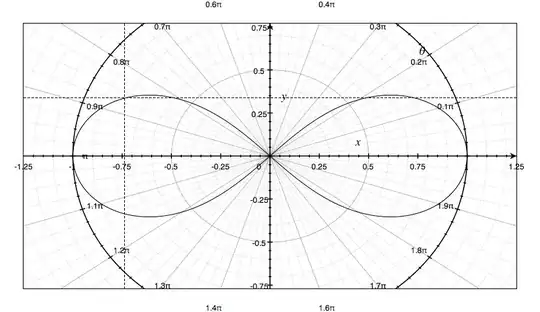

Lemniscate is a well-known $\infty$-shaped algebraic curve of the fourth order
lemniscate
given in Cartesian coordinates by the equation:
$$(x^2+y^2)^2=a^2(x^2-y^2)$$
and in polar coordinates by
$$\rho=\sqrt{\cos2\theta}$$
Setting $$y=xt$$ it is also possible to obtain a rational parametrisation.

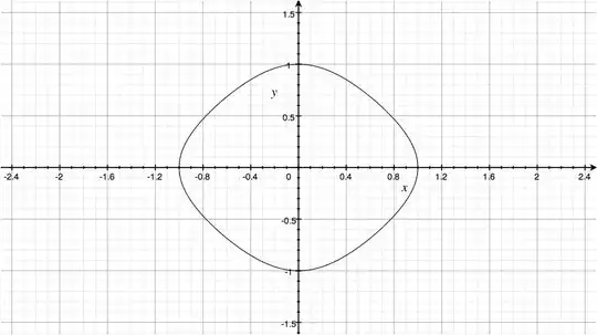

Now if we plot the identity for the lemniscate functions, we get something that is nowhere near that shape:
lemniscate identity
Still, lemniscate functions do give a representation for the lemniscate in the following polar form: $$\rho=\operatorname{sinlemn} \theta$$ in the same fashion as the circle is given by $$\rho=\sin \theta$$
