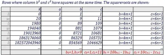

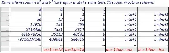

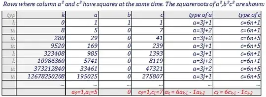

But that ansatz gave the idea for an impressive heuristic table with a not-too-difficult structure, which show the path, how one should proceed analytically from the previous steps. Here is the table of only that rows, where squares occur at least in two columns simultanously. Furthermore I've ordered and separated that table in three partial tables and find elegant recursive formulae for the columns which strongly suggest, that there are no solutions where all three columns have a square on then same row, because the two partial sequences of each columns are completely listed in the three tables and by the extremely clear structure there seem to be no room in the scheme for a "surprising" match of all tables in one special row.
Here are three tables for the matches of columns $a,c$, $b,c$ and $a,b$ The only threefold match $a,b,c$ is $k=0,a^2=b^2=c^2=1$
table a_c:
The recursion for the $k$-entries is $k_0=0,k_1=8$, $k_{i+2}=34 k_{i+1} - k_i + 8$
table _bc:
The recursion for the $k$-entries is $k_0=0,k_1=20$, $k_{i+2}=98 k_{i+1} - k_i + 20 $
table ab_:
The recursion for the $k$-entries is $k_0=0,k_1=56$, $k_{i+2}=194 k_{i+1} - k_i + 56 $
The columns $k$ in each table have the first nonzero value as common factor. If we build the lcm() of the three common factors $8,20,56$ we get the number $280$ (which @Lucian had already pointed at) which must thus be a factor of the $k$-value for any perfect triplett solution.
I think this structures help to find an elementary access onto the deeper (and required) analytical considerations.
