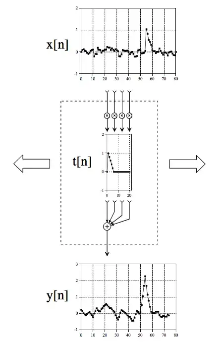

Just to provide some extra context, The Scientist and Engineer's Guide to Digital Signal Processing, asserts:
The amplitude of each sample in the cross-correlation signal is a measure of how much the received signal resembles the target signal, at that location. This means that a peak will occur in the cross-correlation signal for every target signal that is present in the received signal.
And the following illustration is provided:
Schematics of a correlation machine
So will adding together all the samples in y[] yield the likelihood of the target existing in the received signal (given such sum from the left side is compared with the sum from the right side)?
