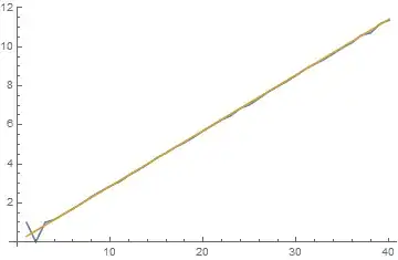

Based on numerical tests, I would say the expected number of survivors for $n>3 \approx n/3.5$

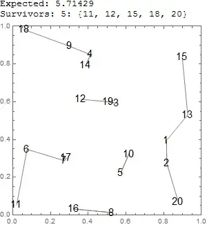

Trial example test[20] (code below):
anim[20,8]:
For $1000$ trials, $1\leq n\leq 40$ est[40,10^3]:

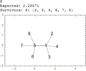

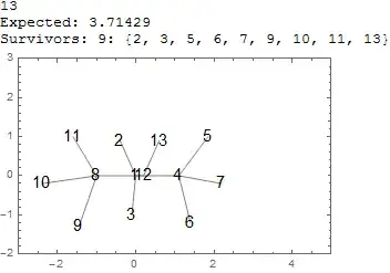

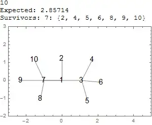

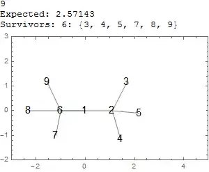

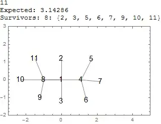

Since arrangements like this
are possible (and their circular counterparts, however unlikely through random point selection), clearly the lower bound for odd $n$ is $1$ and for even $n$ it is $0$ (since the points can be paired).

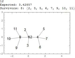

Finding an upper bound is less obvious though. Looking at this sketch proof for upper bound $n=10$ provided by @JohnSmith in the comments, it is easy to see that the upper bound is $7:$

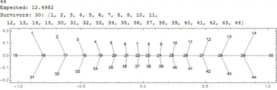

and by employing the same method, upper bounds for larger $n$ can be constructed:
Assuming one can repeat this process indefinitely, it is likely that an upper bound for $n\geq 6$ then is $n-\lfloor n/3\rfloor:$

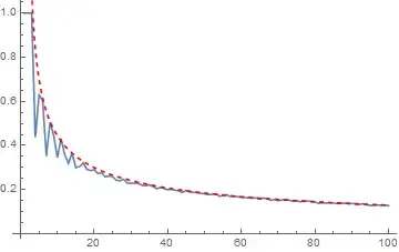

which has been set against the data for $2\cdot 10^4$ trials (red dots - see data below).

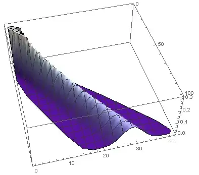

Regarding density of spread, (again with $2\cdot 10^4$ trials) produces the following plot:
ListPlot3D[Flatten[data, 1], ColorFunction -> "LakeColors"]
(courtesy of @AlexeiBoulbitch here), and regarding max. density of spread along $x/z$ axes from above plot, produces the following:

It is tempting to conjecture max height of distribution to be $\approx (c+1)/\sqrt{n-(c+1)^2},$ but of course this is largely empirical.

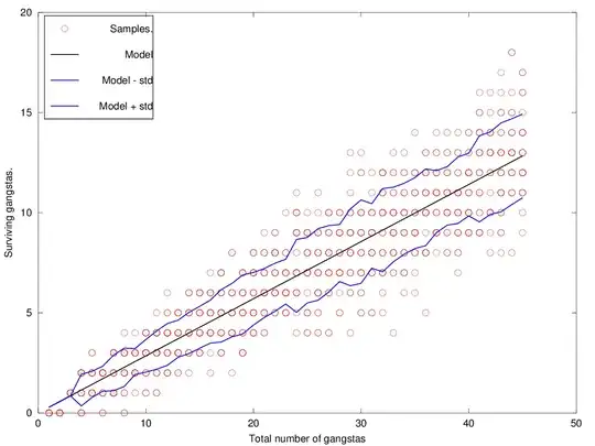

    @martin I just coded it up in c++ using a $O(n\log(n))$ neighbor search algorithm. It looks promising and I'm able to do like $10^3$ samples in $\lesssim 1 $sec for $n_{\rm players}=10^3$ so I can go to quite large $n$. Some preliminary results can be seen here (showing running average). I have not checked everything yet so it might be some bugs however it looks like the Tao&Wu constant is a bit too low ($\sim 10^{-4}$). – Winther Oct 12 '15 at 21:13
  • @Winther how is the bug search going? I would be very interested to see any progress you make with this :) – martin Oct 13 '15 at 10:45
    @martin Unfortunately, I have not had much time to play with this. I updated the plot above with some new runs where it looks like we are have something like $\lim_{n\to\infty} E[n]/n = 0.28417 \pm 0.00002$. The code I used to generate the data for the plot can be found here if you want to try it. – Winther Oct 13 '15 at 13:55
