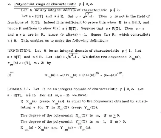

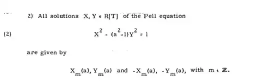

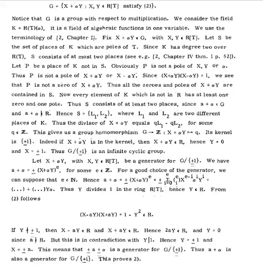

At the paper that I am looking I found the corresponding lemma for the case that the characteristic is not $2$ and its proof:
PROOF.
I want to try to do the same for the case $\text{char}=2$ but first I have to clarify some points at the proof above.
Why do we consider the field $K=R(t)(a)$?
Is $S$ the set of points at which the functions of $K$ are not defined?
