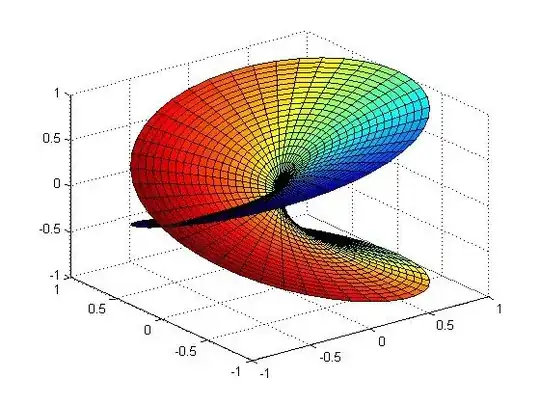

There are other ways to address the issue. The nicest is the theory of Riemann surfaces. The idea here is that you think of $\sqrt{z}$ as a function on a set that is larger than just the complex plane. The Riemannn surface for square root is essentially 2 copies of the complex plane, split at the branch cuts and glued to each other. Here is an image, taken from Wikipedia, for the Riemann surface for the square root function:Riemann surface for the square root
This approach is not without fault either, since you're now no longer talking strictly about the square root of a complex number. The points on the Riemann surface tell you which square root to pick, and there is one point for each square root. Since -1 is a complex number, not a point on the surface, $\sqrt{-1}$ doesn't make sense. However, there are 2 points corresponding to -1, one of which has square root $i$ and the other one $-i$.
