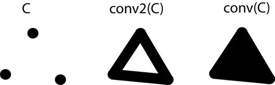

For a very simple counter example let $x_1 \neq x_2 \neq x_3 \in \mathbb R^2$ (and also assume they are not collinear). Then our counterexample is the set $C=\{x_1,x_2,x_3\}$. I will denote by $conv2(C)$ your second definition of a "convex hull". Then graphically we get (blame my graphic skills for the rounded corners):
convex hull
