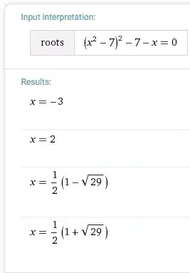

One can show that the limit does not exist by contradiction. Suppose $\lim_na_n$ exists. Then we must have that $x=:\lim_na_{2n}$ and $y:=\lim_na_{2n+1}$ both exists. We show that $x\neq y$ and thus have a contradiction.
By the recursive relation, one has $$ a_{2n+1}=\sqrt{7-\sqrt{7+a_{2n-1}}},\quad a_{2n}=\sqrt{7+\sqrt{7-a_{2n-2}}} $$ which implies by taking the limit and the continuity of square root that $$ y=\sqrt{7-\sqrt{7+y}}\qquad(1)\\ x=\sqrt{7+\sqrt{7-x}}\qquad(2) $$ One can check that solutions to (1) and (2) can never be the same: enter image description here enter image description here
