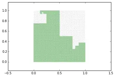

I wrote a program to address this question: exploring the hilbert space-filling curve
Here is the image of the interval $[\frac{1}{18}, \frac{1}{\sqrt{2}}]$ of the Hilbert space-filling curve.enter image description here.
Notice it is the union of countably many dyadic squares.
